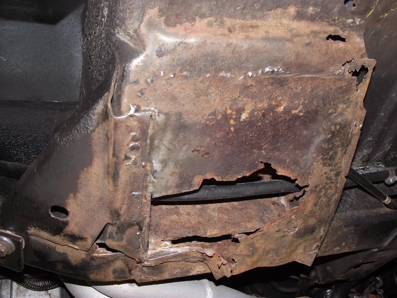

Here's a picture of my left side torque box - after I took off the piece of thin sheetmetal the PO had tack welded over the rust.
There is no upper panel on the original torque box and as you can see, the bottom is pretty much gone too - as is some of the frame rail. I bought the torque boxes from NPD and a set of rails but I think I'll cut/fabricate/patch the rail and just use the NPD ones as paterns and then return them.
I got the largest chunk of rusted metal out yesterday but now need to go back and cut a few spot welds and grind away some beads to get it to where I can start fabricating.
Oh, and there's a nice 1/2" gap at the top between the top of the TB and the firewall. That will be addressed as well.

Here's what I cut out of the left side - The torque box, a chunk of the inner rocker, a chunk of the frame extension and a piece of the front frame where it fits inside the rear extension.
I got some .07" and .10" sheet stock that I'll cut, form and weld in. I'm going to weld in a 3/16" x 1.25" angle iron support inside the rail prior to welding on the 'skin' for a little extra support.
