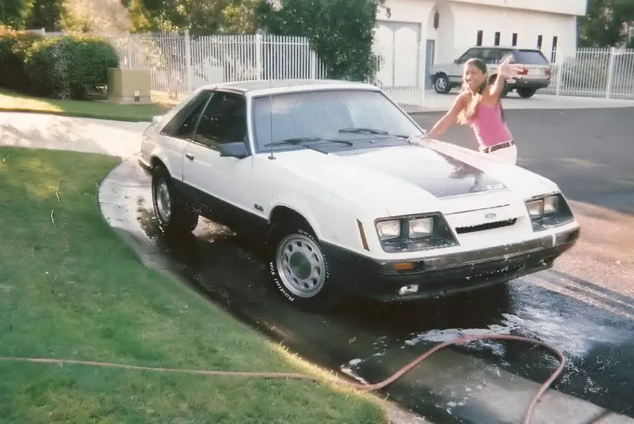

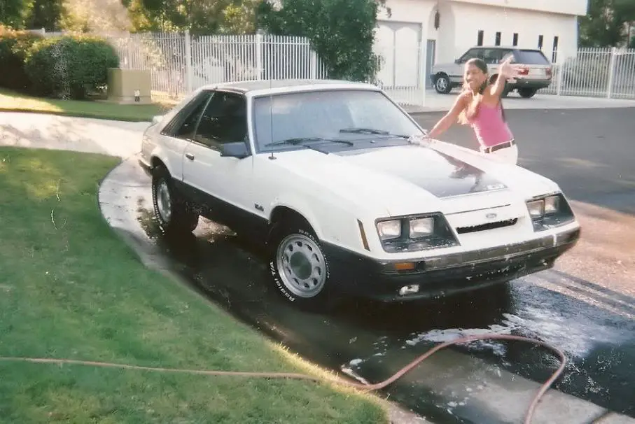

I am buying the 93 CobraR brake kit from ford racing and have been told that it won't go into an 86 mustang. does anyone know why it would fit an 87 - 93 but not an 86? Does anyone know of other 4 wheel complete disc brake kits that would fit an 86 and convert to 5 lug? thanks in advance for any help.:flag:
