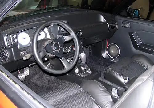

I can tell you that the clutch and brake pedals are a completely different shape in the Fox cars. I've seen them in Foxes though and would like to know how it's done as well.
I have them in my Fox. The brake pedal is a REAL tight fit but a little trimming and/or some lube/soap/oil to help it slide on will do the trick. That's what I did for the AOD brake pedal.
Gas and dead pedal are a direct swap... I trimmed the brake and clutch pedal with a die grinder..
Ditto. But I used a hack saw on my pedals. One of them I was able to get installed pretty easily, but the other one required cutting. And then I used some epoxy to permanently attach the brake and clutch.
As for the differences, the fox pedals are more like a parallelogram, all sides the same basic size, like this: / / while the SN95 ones are more like a trapezoid like this: \ /
Anyway, they sure do look nicer when clean!
