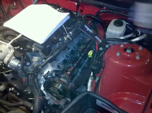

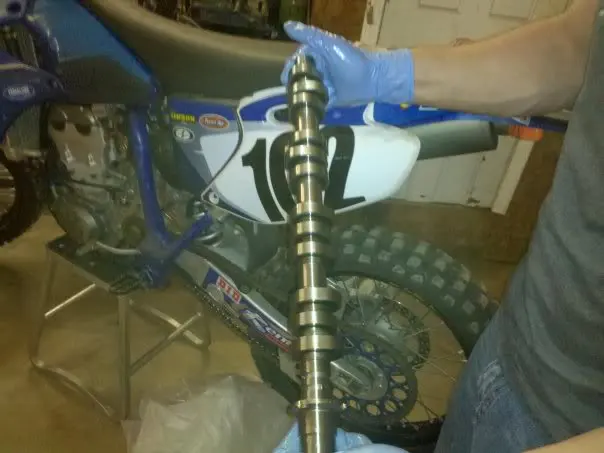

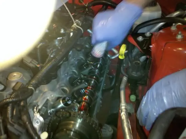

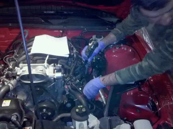

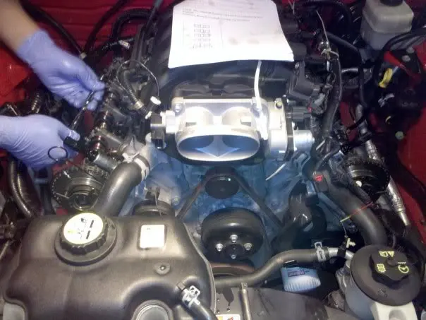

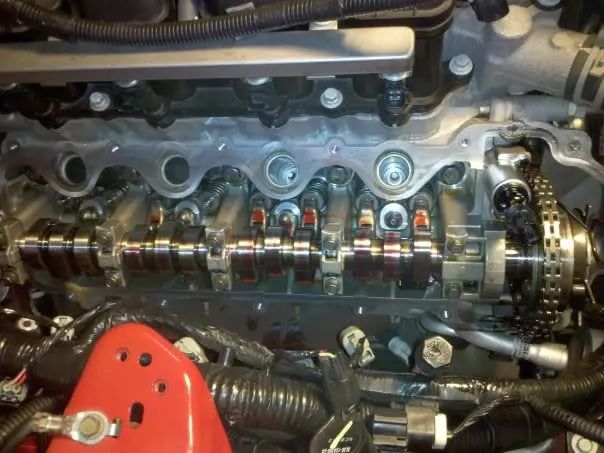

After some shopping around(most shops wanted about $750!), I installed the Hot Rods on my 05 GT yesterday myself. I am by no means a mechanic(the hardest I had ever done was a top end rebuild on a 2-stroke MX bike before this) and it took me and a friend about 6 hours from start to finish. I used a custom tune from Brenspeed and it runs strong, especially on the top end....and of course you can't beat that old school lope!:D

I bought the timing chain wedge from FordSpecialTools.com and that was the only special tool I needed. I did a lot of research and determined the valve spring compressor is not really necessary(and if you crank on that compressor too much you can actually push the valve down into the head)and I just used a thick shafted flat head screwdriver to pop the followers out. The service manual makes the install seem really difficult and intimidating but it's really not....like I said, just take your time.
