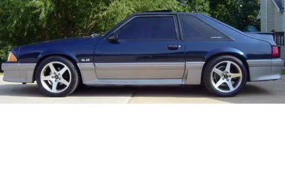

Does any one have anything to say, good or bad, about the Ford lowering springs? (They are alot cheaper than other springs on the market) How much would they lower a 91 GT? I currently have H&R Sepersports on my car and it is rubbing badly so I'm hoping that some Ford springs won't lower it as much. Here is a picture of my car.

i agree. thats a nice stance
i have fms springs in the front with 18's, and i had to get eibachs in the rear to even out the difference. had 1/2" gap in the front, and over 2 1/2" in the rear :shock:
what is the advertised drop on the h&r springs? i believe fms will give you about 3/4" front, and 1/2" rear drop

Maximum Motorsorts Advertises the drop of H&R's as 1.25 inch in the front and 1.0 in the rear. However, I think they droped my car more than that. My main concern is the front because you can't roll the fender if you are rubbing.
When shocks wear they sag....so that could be the problem. Your car does have a nice stance! I had a civic (i know sacraligious) that had adjustable coil -overs. When the shock started to go there was nothing I Could do to stop the rubbing. Even at full lift on the spring it still rubbed. I would upgrade the shocks, even if it doesn't fix the problem you still get much better handling.

Not to change the subject, but those wheels look soooo sweet! :nice:
