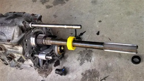

Did you peer inside the hole in the trans and see if the drive gear was stripped or in place?
The drive gear on the t5 is held in place with a small clip and it's not uncommon for the clip to break and the drive gear to walk up the shaft and not contact the driven gear

Yeah I did see a gear in there. I couldn’t say if it was in exact spot it should be though.... I wonder if I stuck speedo gear in there by itself if I could see if they made contact. Sounds like an idea
Pull the clip and cable from the trans and put a cordless drill on it while someone watches the speedometer.
If it works, you know the problem is in the trans, I think you can pull the tailshaft housing without pulling the trans, but I've never personally tried it.
If you do have to open the trans, use one of the speedometer gear kits at LMR or similar for the gear set you have.

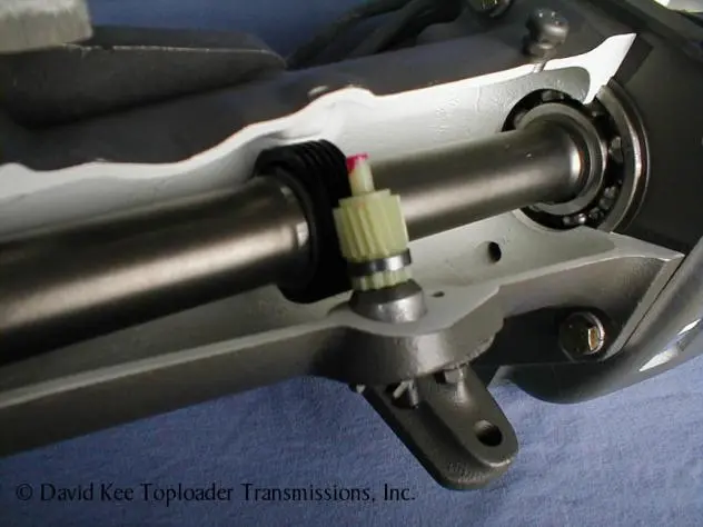

If you are getting feedback from the speedo by spinning the cable down at the trans, the issue is most likely the driven/drive gear interface.
Is the drive gear centered in the speedo hole?
This isn't a t5 setup, but the drive/driven gear layout is the same. Drive gear is centered to the driven gear when you insert it
Great question, the gear inside of the trans is not centered in the hole. I had to reach my finger around to one side to feel it. I could see it though. So if you are saying that gear should be centered I’d say that was the problem
Gotta get a second look sometime but all signs are pointing there unfortunately
