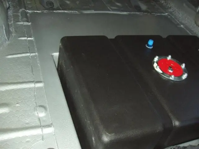

It all depends on what you are doing it for. If for using at any NHRA santioned tracks, and a plastic cell, only the fuel pick ups can protrude outside of a metal enclosure.
Here is what I did for mine:
Full detailes here:
http://www.qsl.net/wd4ngb/birdworka2.htm
