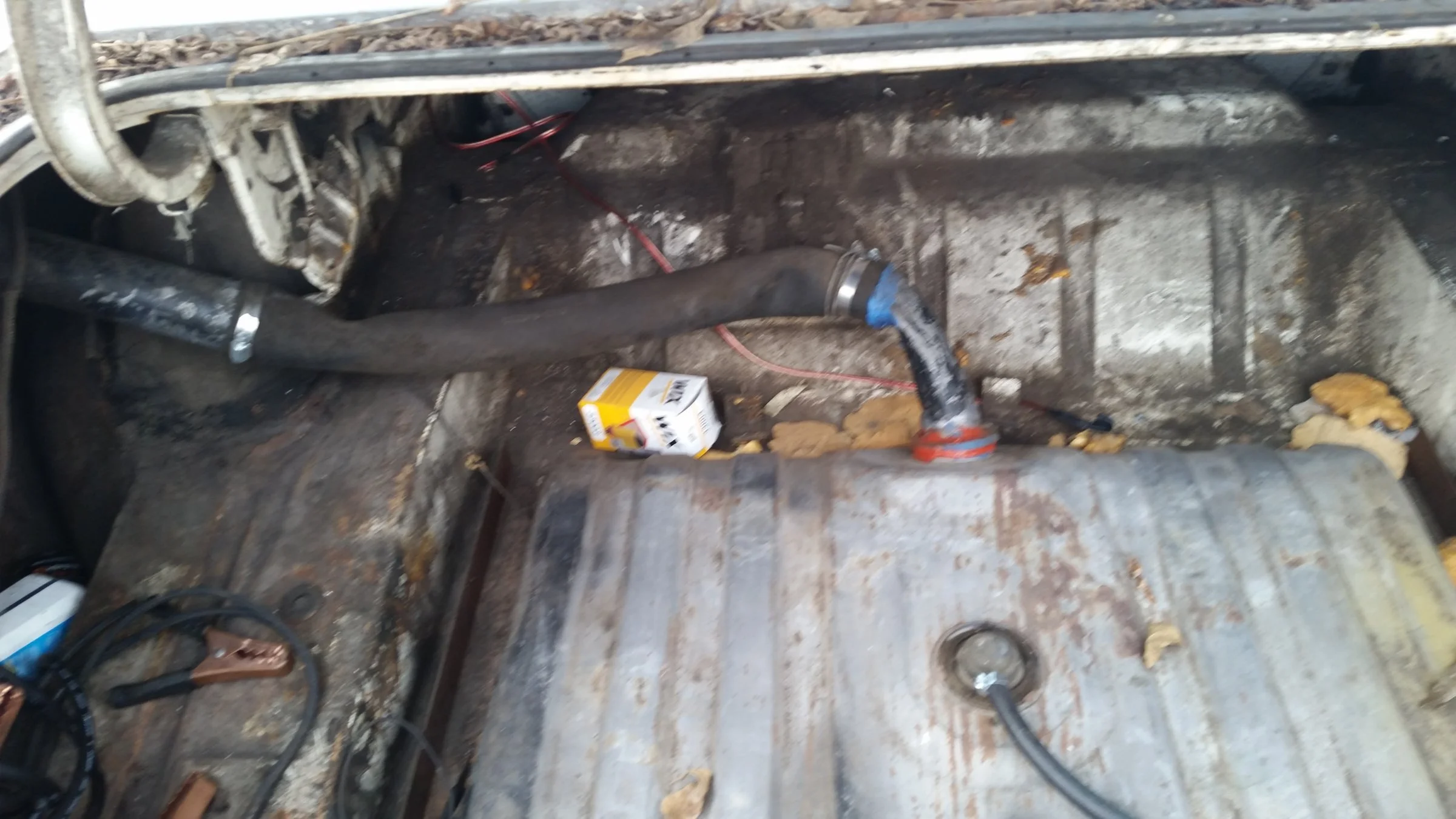

Hi, well here's my plan givin i'll have a bit to spend here soon...i'm dead set on converting my 68 falcon to efi. I will be going with FiTech 600 that is decided. I have been researching and digging around for two weeks so far and I think I have talked myself out of the fuel command center. Now, I am posting here with hopes that someone has done something similar..Did you find a fuel cell that made sense in the floorless trunk? Or did you work with the stock tank? The tank in my car isn't original, the filler neck is centered while falcon should be on the drivers side. There isn't a drain plug either. Is there a known sending unit with a return fitting so I can just go inline? Opinion? Input? 20170206_140716.webp Someone was custom.
