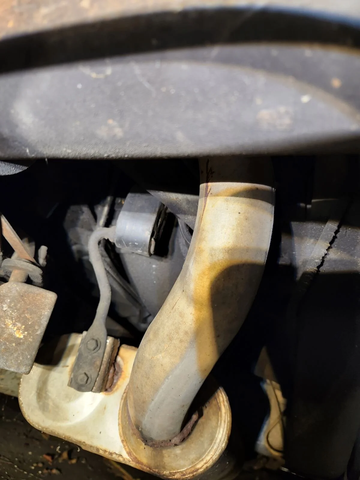

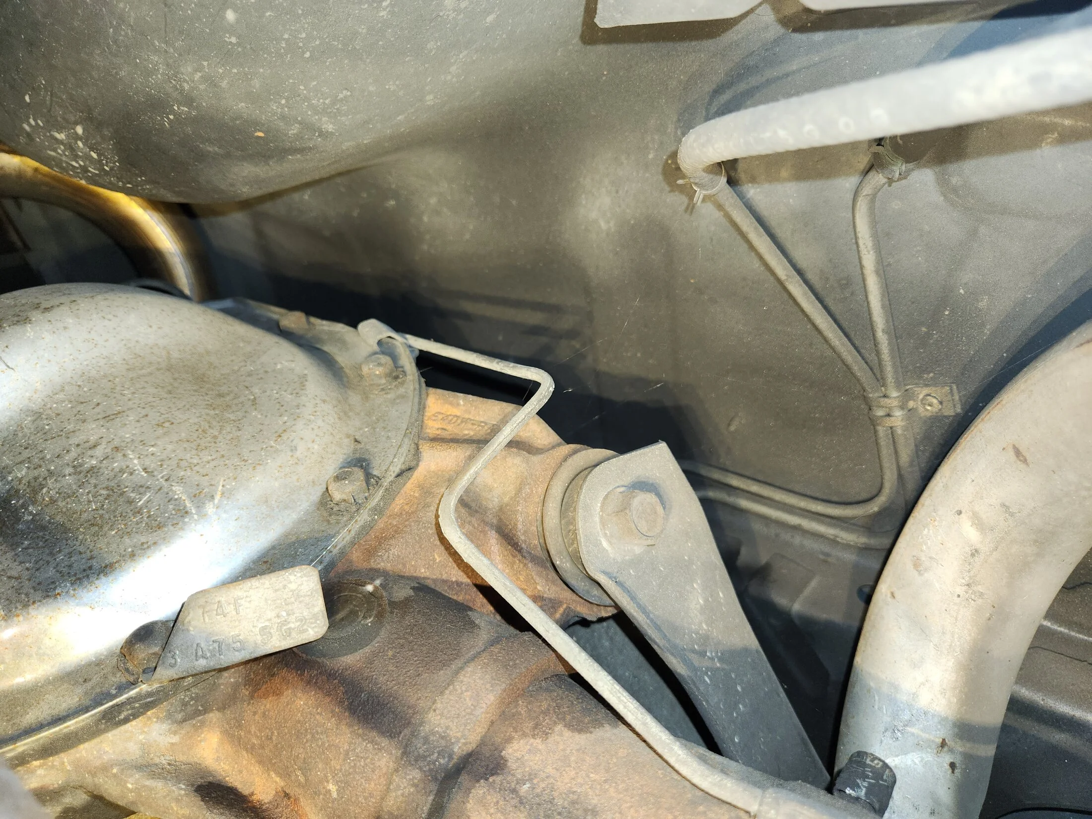

Problem seems to be fuel lines only, From what I can see they need to be routed differently to work,, The loop in the exhaust that goes over the rear axle hits them.....
Viewing from the back of the car (and keeping in mind, at the time, I was only able to see forward of the rearend about a foot or so due to my point of view), the fuel lines run down the passenger side of the driveshaft tunnel, along the edge where the tunnel meets the floorboard (see 1st pic). Once the driveshaft tunnel ends and it transitions into the side-to-side rearend tunnel, the fuel lines continue rearward, hugging the upward curvature of the rearend tunnel, to the peak of that tunnel. At that point they turn 90° towards the passenger side for about 6". They then turn rearward again for less than a foot before they end and the rubber lines begin (see 2nd pic).

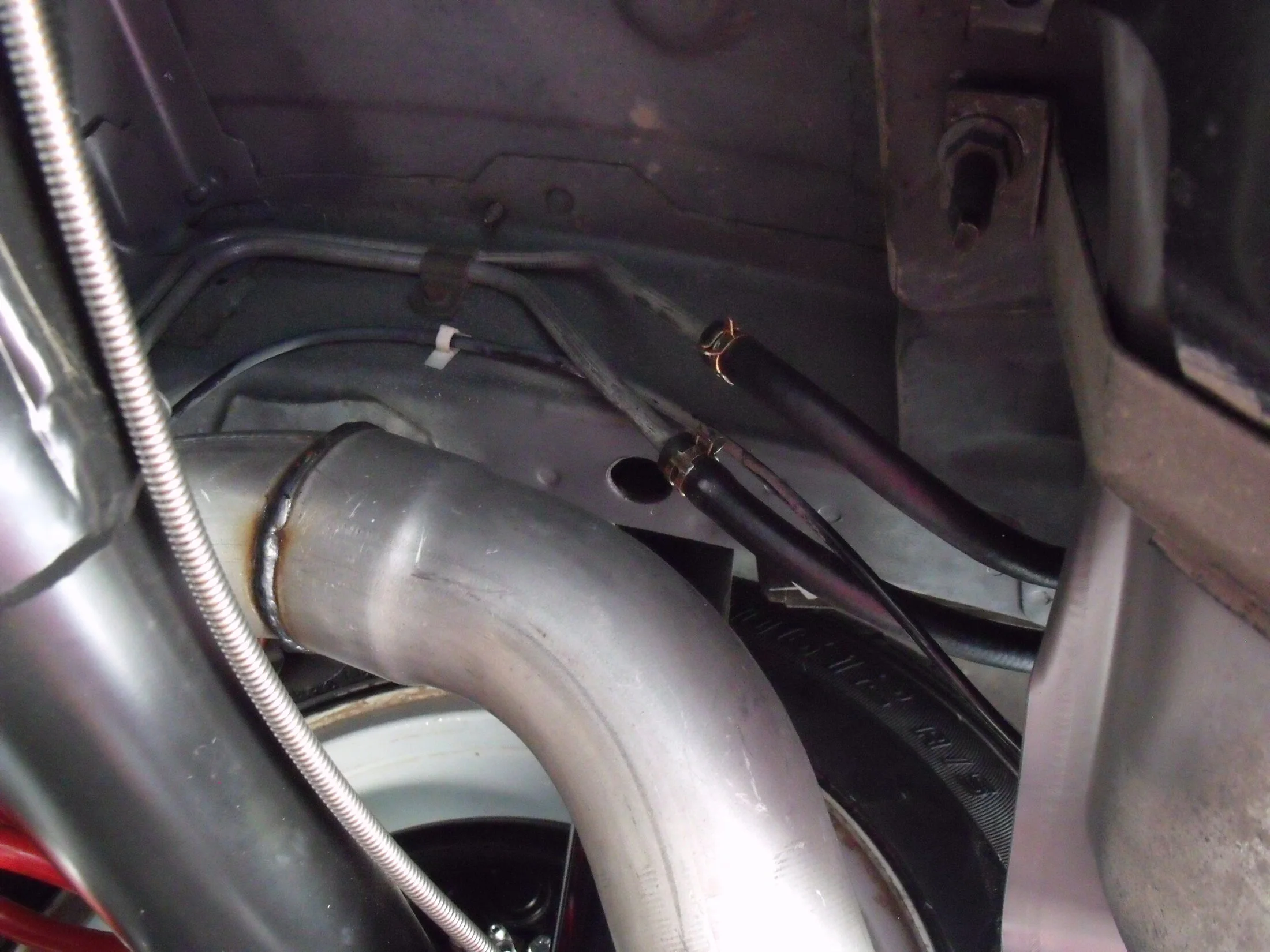

Looking more for a pic showing if the 85 fuel line routing goes into the tunnel, like the newer brake lines do, instead of down he frame rail
Yes, the fuel lines run down the driveshaft tunnel, at least under the rear seat area. They do not at any point (that I could see) run down the passenger side frame rail. I actually think coming out of the engine compartment that they run down the driver's side frame rail until somewhere around the middle of the length of the car. At that point they turn 90° inward, going to the driveshaft tunnel, then up and over the driveshaft while hugging the tunnel, to the passenger side floorboard of the tunnel. At that point they turn rearward and progress as detailed in the previous paragraph. Again, the route from the engine compartment to the passenger side of the driveshaft tunnel is just a semi-educated guess.... I haven't actually viewed that part yet. :shrug:

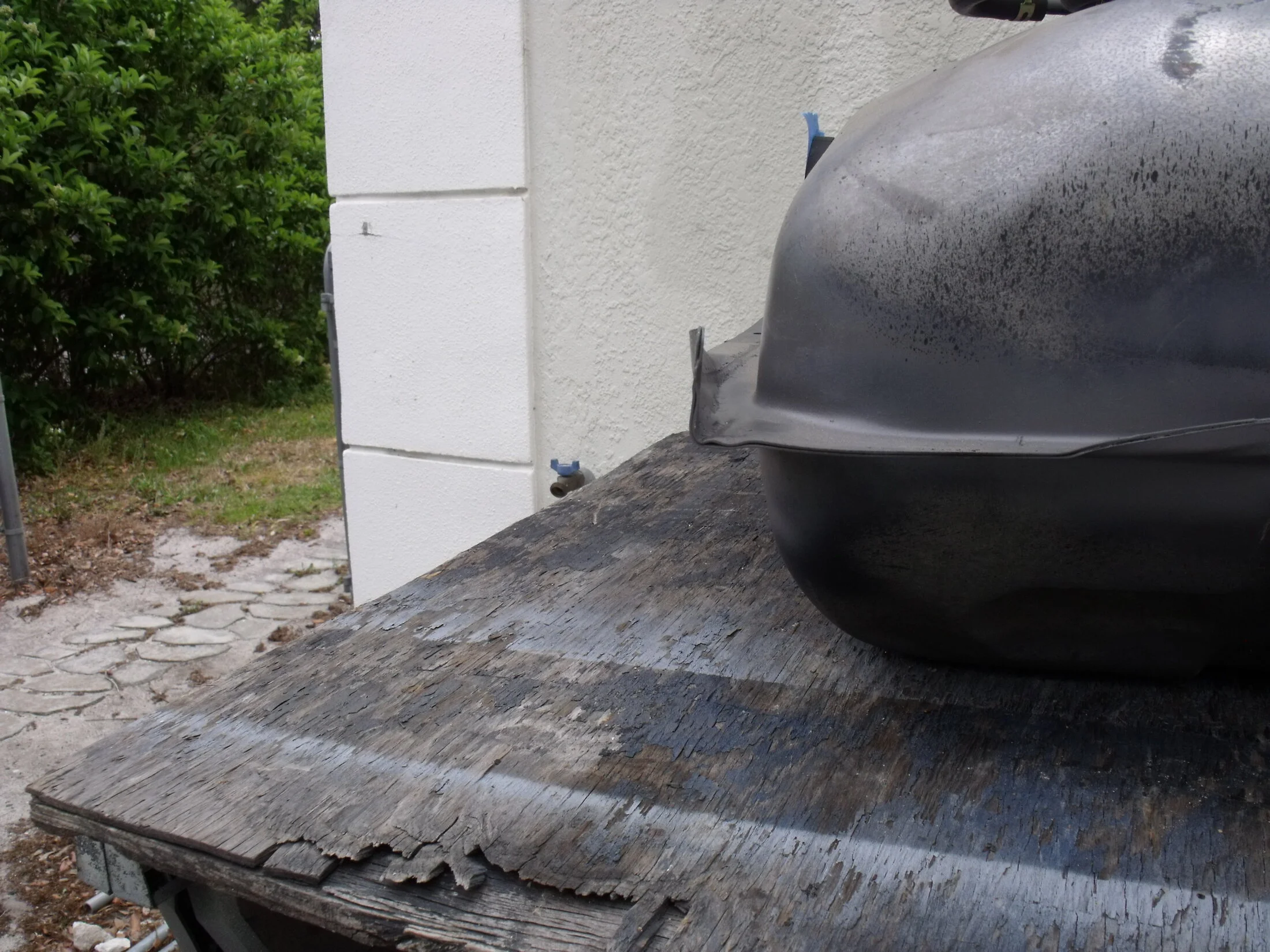

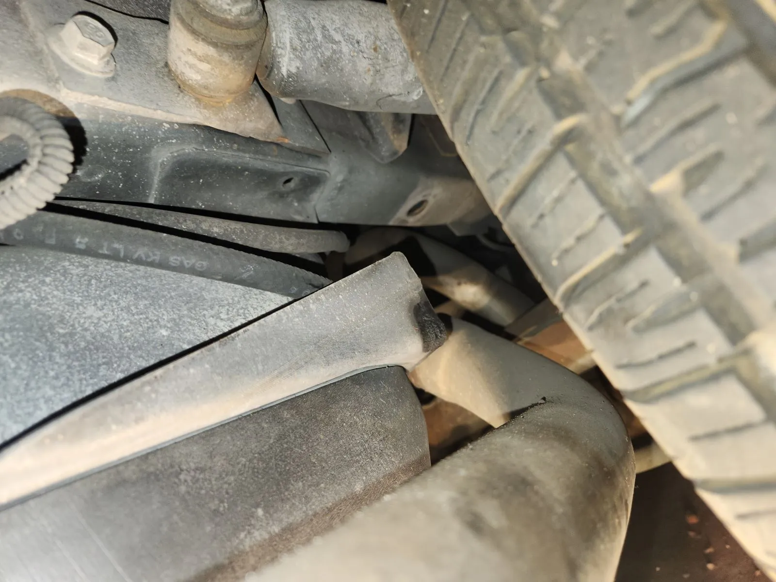

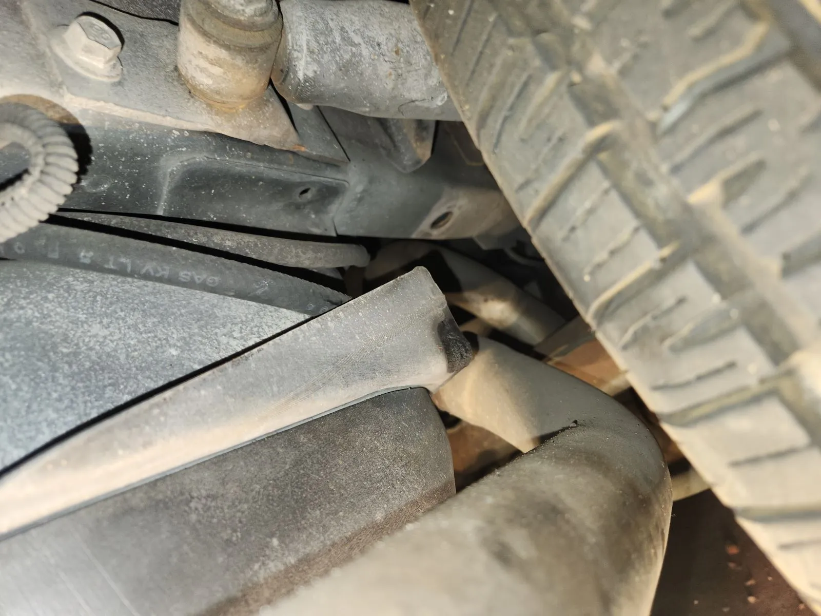

Some pics of my fuel tank.. The flange on the front right side is bent down and is in the way of the exhaust..
Looked at some pics and the fuel tanks I looked at either had a nice rounded seam with NO extra or if it had a flange it was bent up??
Yea, my flange is definitely bent up.

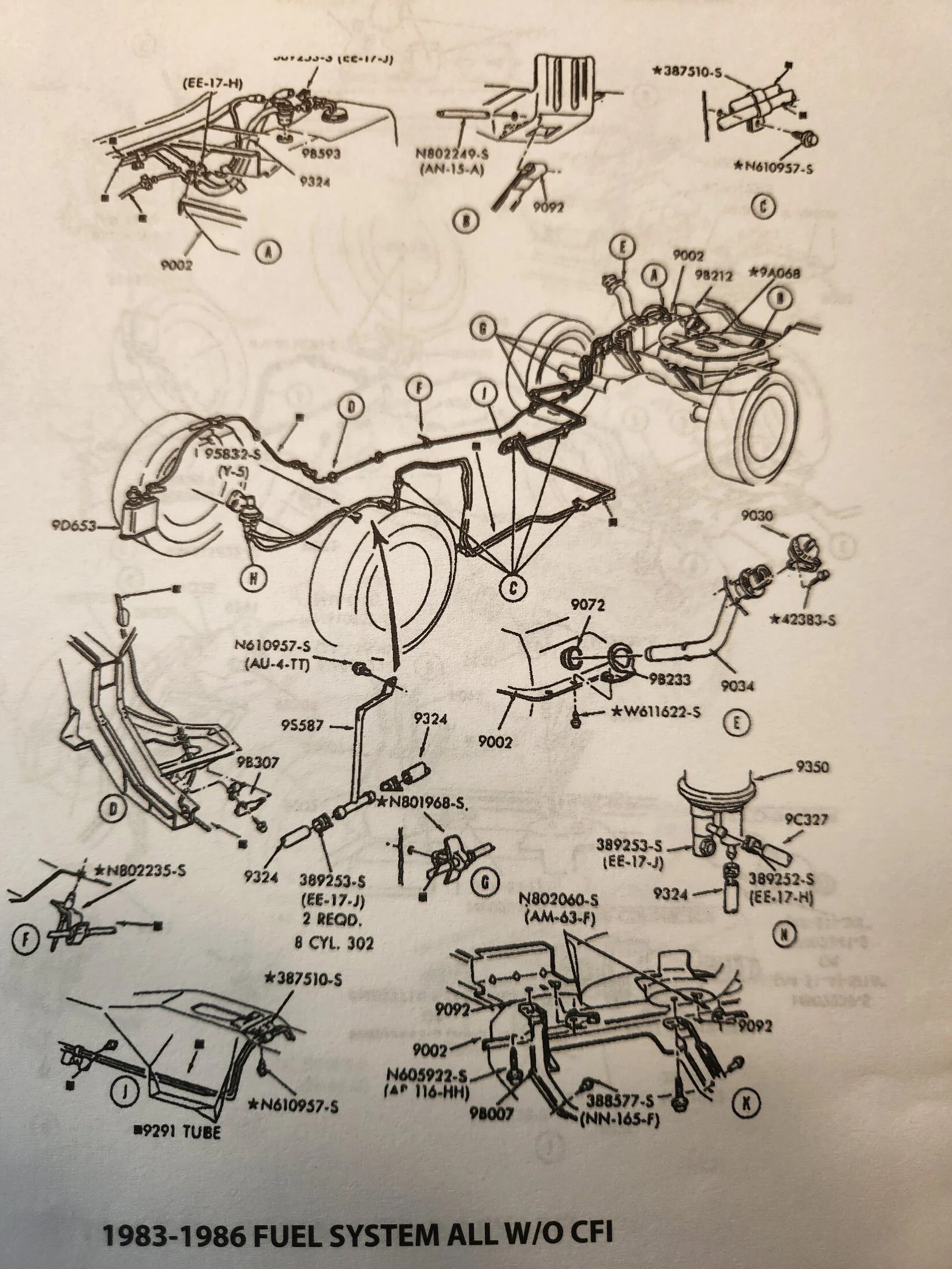

I have looked for exhaust and fuel line diagrams for 85's, and cannot find any on line....
The fuel system exploded view actually shows the same layout for 1983-1986 V-8's (w/o CFI). So I question whether that fuel system diagram is 100% correct. (Note: I have found other errors in this particular exploded view manual before.)

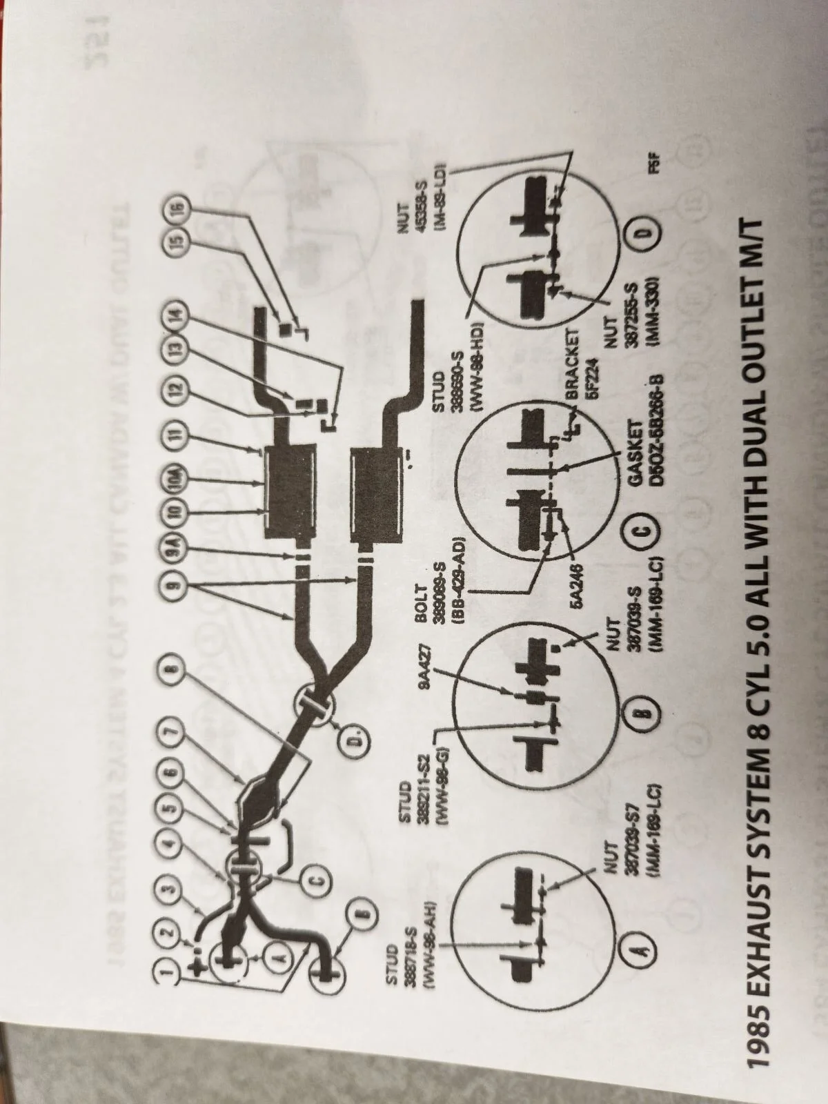

After further research, it looks like the fuel line routing drawing I have may be correct. I came across the same pic in another source. So here's what I found...

Based on what I can see on the exhaust, I need to bend my tank or get another... The right exhaust pipe will not fit otherwise..
Completely different fuel line route, but not unlike the same change in the 87 up brake lines...
Your exhaust diagram is not what I expected, Figured a single muffler and the split back to two tailpipes after the muffler,,,, TY for adding that...

"This" tank was the 79-85 carbureted tank that has that flange turned down. From the pictures of your car I am wondering if the '85 was a one year only. The odds of the aftermarket making a part for a one year only Fox is about zero in my experience. From that and what is offered it looks like they no longer make tanks for the 79 - mid '81 cars, lumped all the late 81-85 cars to one tank, and all the 86-93 cars to another tank.

Hope to pull the fuel tank later today and see if I can bend it....

I'd definitely give it a try. You said you had a heat gun, right? Those can get pretty damn hot. I'd heat the heck out of that corner, put some vice grips on it and I think it'll give way easily. It is relatively thin metal, so I think you'll be successful. Fingers crossed for ya.

OK, so it looks like my tank is an 85 tank now? Large pliers and a hammer and I think it might work...
No heat used. the metal is pretty maleable.. Gas in it and I leaned it over to that side and no leaks so I might call this good..

@limp - I added a comment and the fuel line routing exploded view to my post # 42 above.... just so everything is together there. It doesn't quite match exactly what I observed on my car, but it's pretty close. It appears to show an extra bend before the partial-loop over the rear axle.... dunno. :shrug:
Appreciate your diligence... The additional diagram looks more like my fuel line rather than yours....
You can see where after it turns back along the tunnel for a bit, it turns 90 degrees to the sub frame, then 90 degrees again towards the back and rides along the sub frame where it dumps into the attached.. Here is a pic of where mine end for the rubber line connectors...
