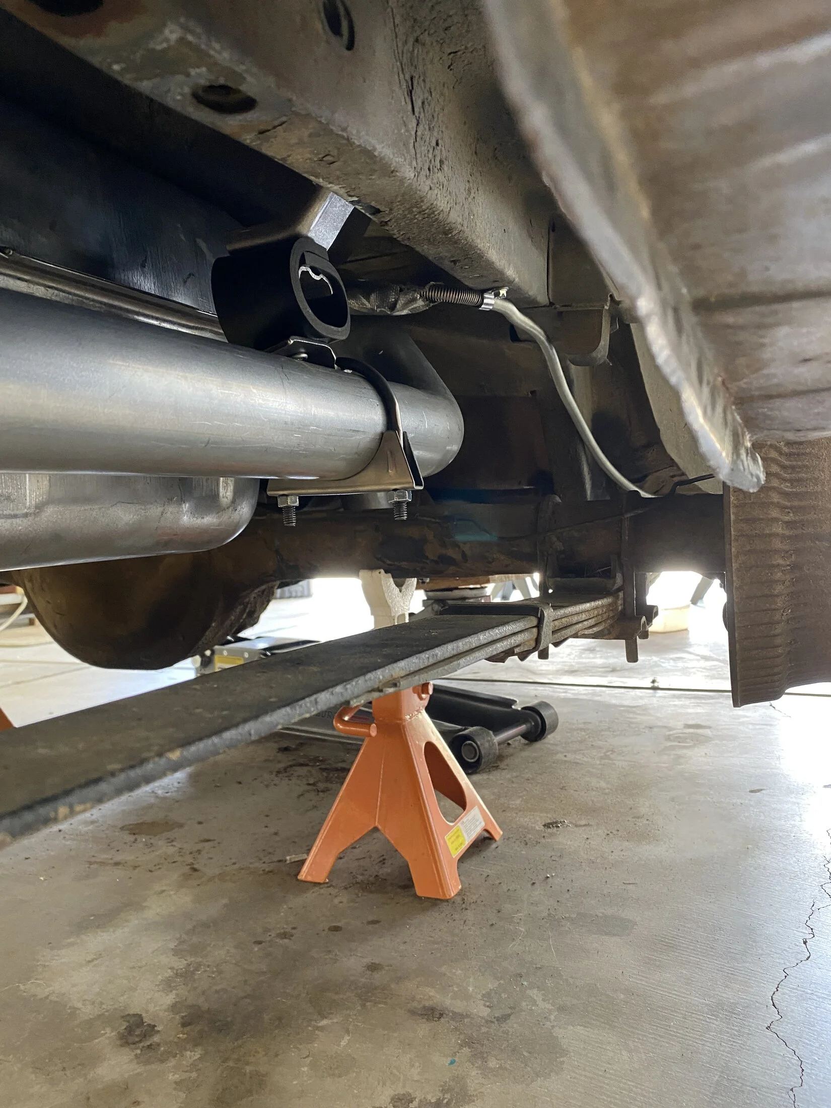

Has anybody else gone from factory single exhaust to dual?
Trying to fit in the right side exhaust pipe today with challenges?
1. right side tail pipe actually pushes on the rubber fuel lines, from the metal lines to the fuel tank, as I push it up where it needs to go.
2. had to change the brake lines to 87-93 lines ( cars is an 83) for the right side exhaust hanger to fit, do i need to update the fuel lines too? I assume they will be different at the engine compartment for Fuel Injection...

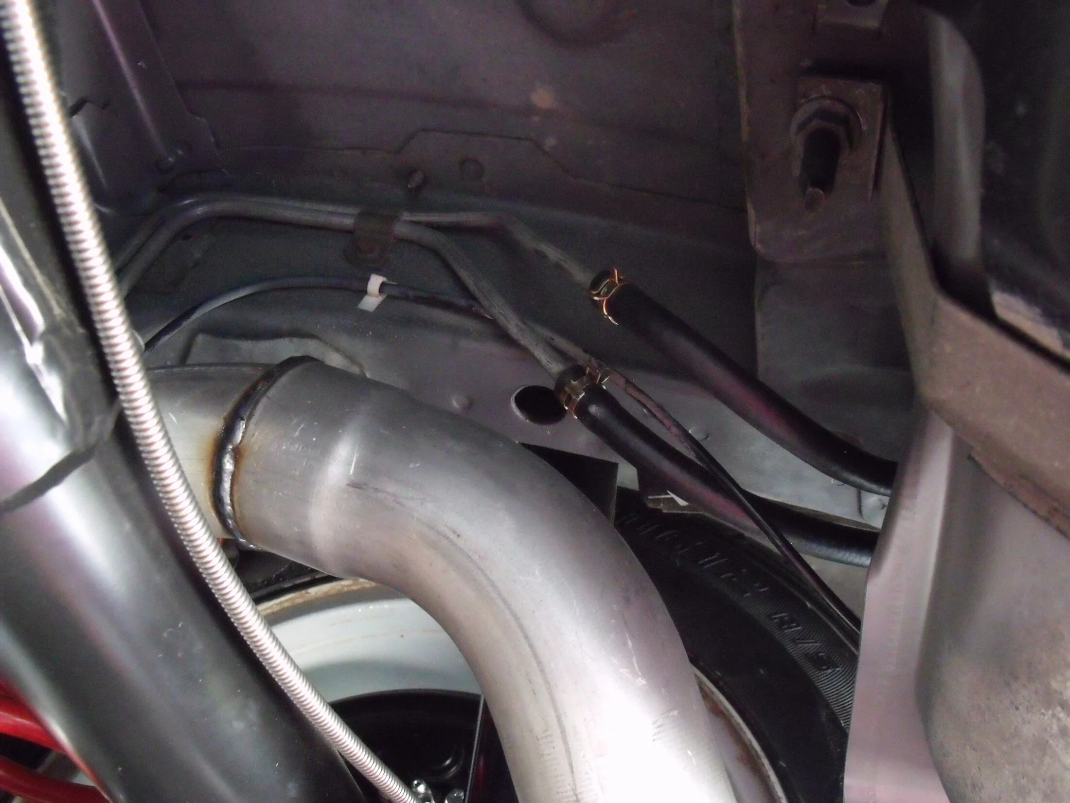

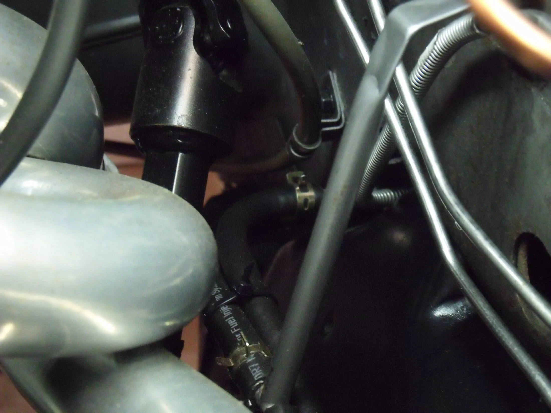

Here is a pic of what I am talking about. The exhaust pipe is not hooked up and sits up 2-3 inches higher, so you can see it is not going to work with these fuel lines...
85 GT, do your fuel lines feed into the engine compartment like in my pic? The clamp in the middle of the pic holds the rubber line to it, which then turns 90 degrees towards the front of the car to the fuel pump..

Hey, appreciate your help . Classic lines builds a 85 GT only line, but they have not been able to answer my questions
The picture of it they show does not look much different than what mine looks like and the front of the line in the engine compartment looks completely different.. so I have been thinking of a plan B...
I might cut the fuel line where it goes UP the frame ( where the rear axle goes up and down) and run the two lines ( fuel and return) in rubber on the bottom of the frame rail with some hanger clips of some sort... Trying to figure this out without it looking cheesy or half a$$ed.....
Was thinking of cutting the fuel line more towards the front of the car and attaching/running a longer braided line with AN fittings up in the tunnel, but that might be plan C if this does not work...
Plan D is putting the single exhaust back in it........
