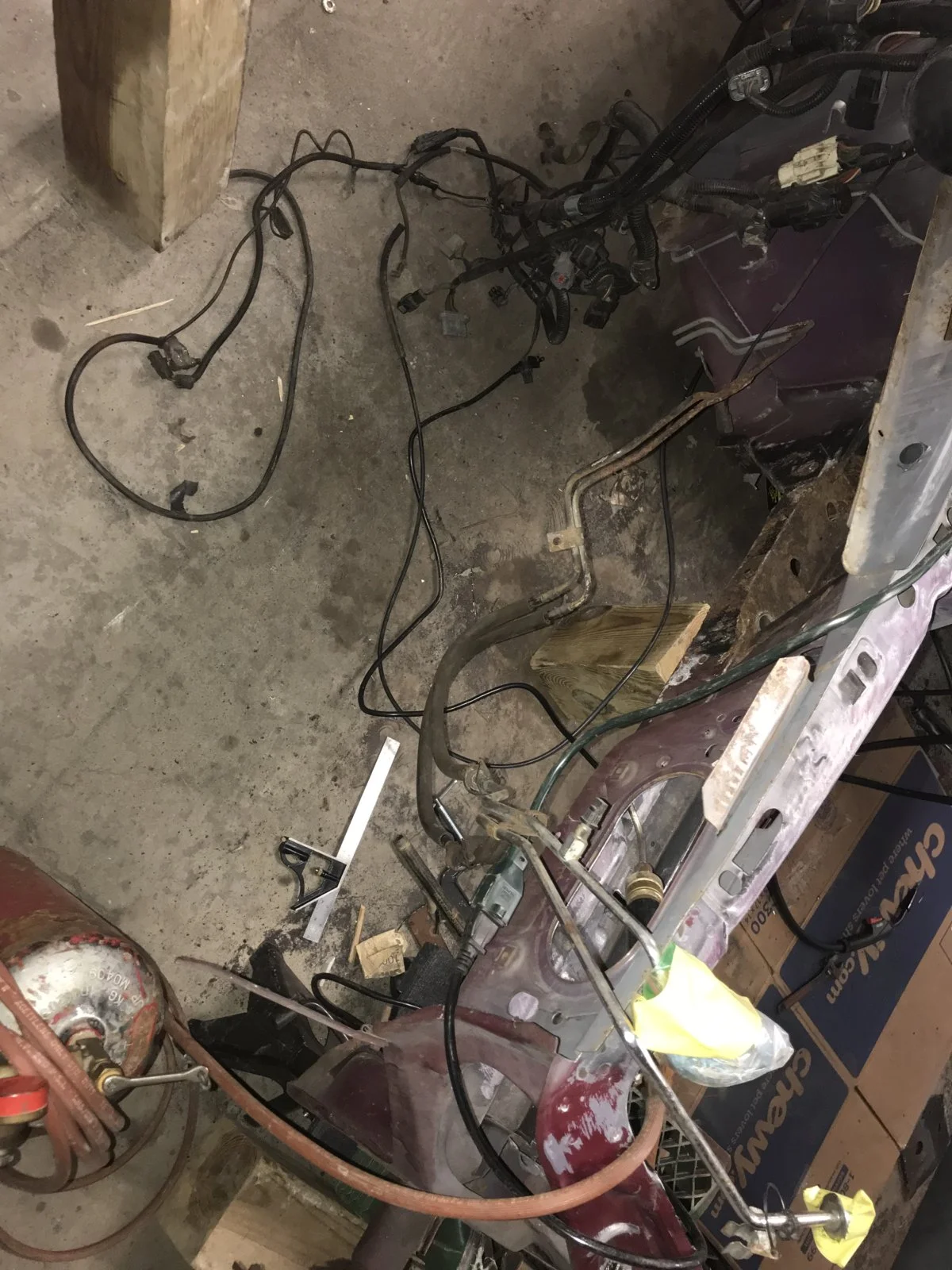

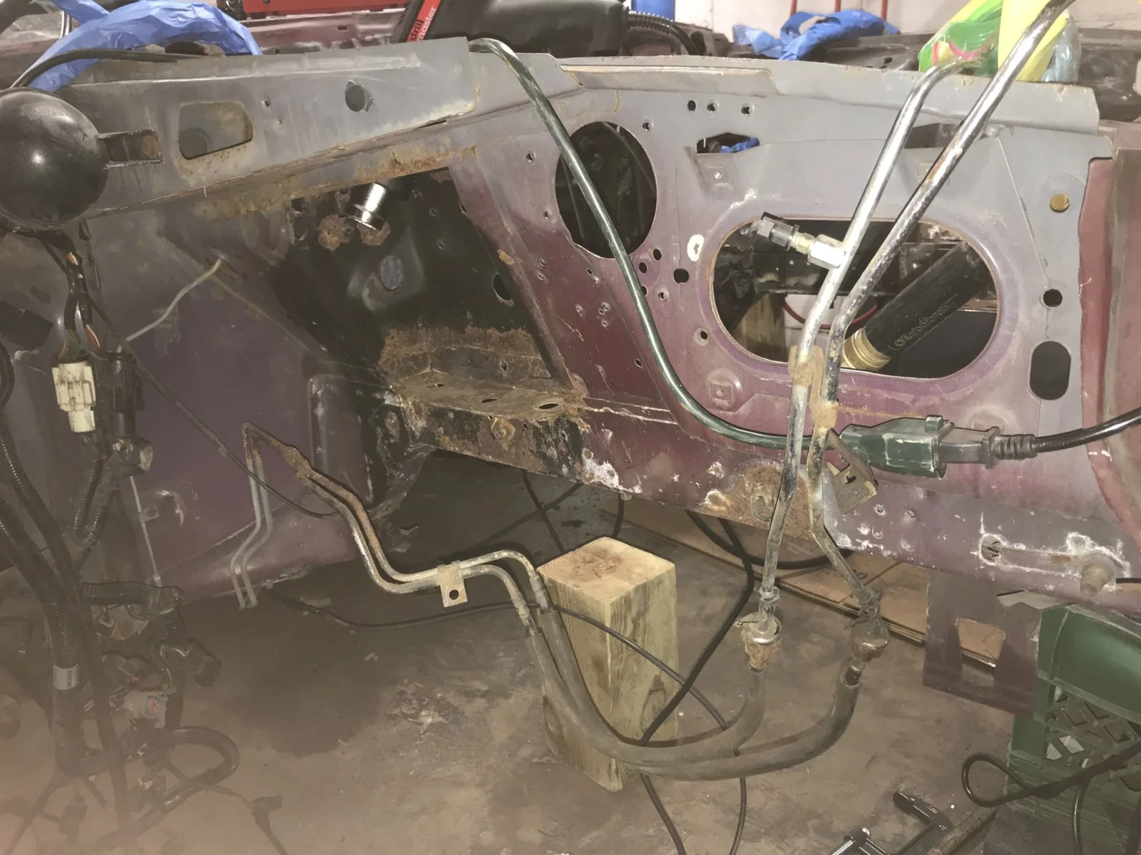

Hey folks, a while back I removed the stock soft fuel lines between the hard lines for replacement on my 92 5.0. Had the car sitting for a few weeks or so and can't remember which hard line is which (feed & return) for the two hard lines that are right in the front pass fender well right before they meet the soft lines. One of them points straight down and the other kinds of bends over towards the engine bay before pointing down. Which is which? (Just to note I did search but all I found was info on the lines at the fuel rails). Appreciate any input!
Are they not two different sizes? Been so long, I know the hard lines are different sizes.
Maybe.
Yes they appear to be different sizes, best description I can give you is looking down at the hoses the inside goes to the inside and the outside goes to the outside hose (the outside hose is the one closest to the engine block.
Not sure if these can help or not
Thx for the help! The pics made it clear for me.... its been along time for me too gk, I built this car years ago and kept the stock fuel lines in. Back in the day I had a buddy of mine tell me the he ran a 700hp set up on the stock lines so I didn't upgrade them. I'm only 500 at the wheels and never had a problem with fuel delivery due to the stock lines. Thx again guys!
