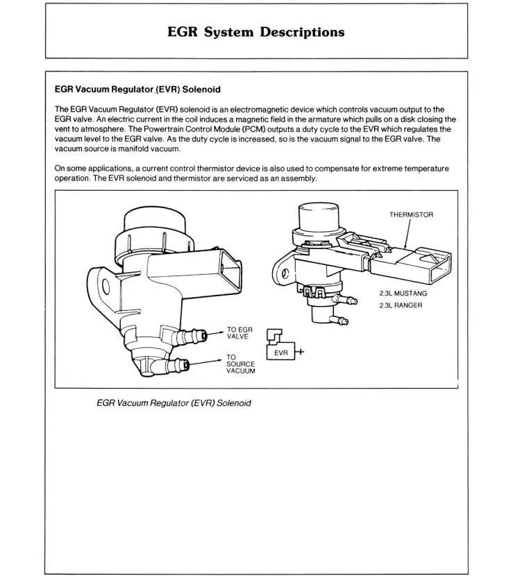

Get rid of the platinum plugs. Mustangs don't like them. You said you replaced the EGR valve. Might check the EVR solenoid. This helped my crappy gas mileage on my '86
What is the EVR solenoid? Where is it located? What is it's function? As far as the plugs are concerned....I'll get rid of the plugs, but what plugs do you recommend I replace them with?

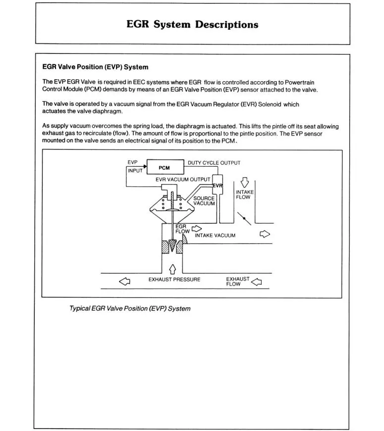

The EVR is an electromagnetic device which controls vacuum output to the EGR valve. The EVR replaces the EGR solenoid vacuum vent valve assembly. An electric current in the coil induces a magnetic field in the armature which pulls on a disk, closing the vent to atmosphere. The ECU outputs a duty cycle to the EVR which regulates the vacuum level to the EGR valve. As the duty cycle is increased, an increased vacuum signal goes to the EGR valve. The vacuum source is manifold vacuum.
