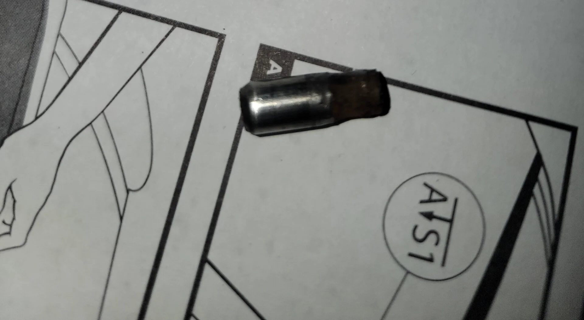

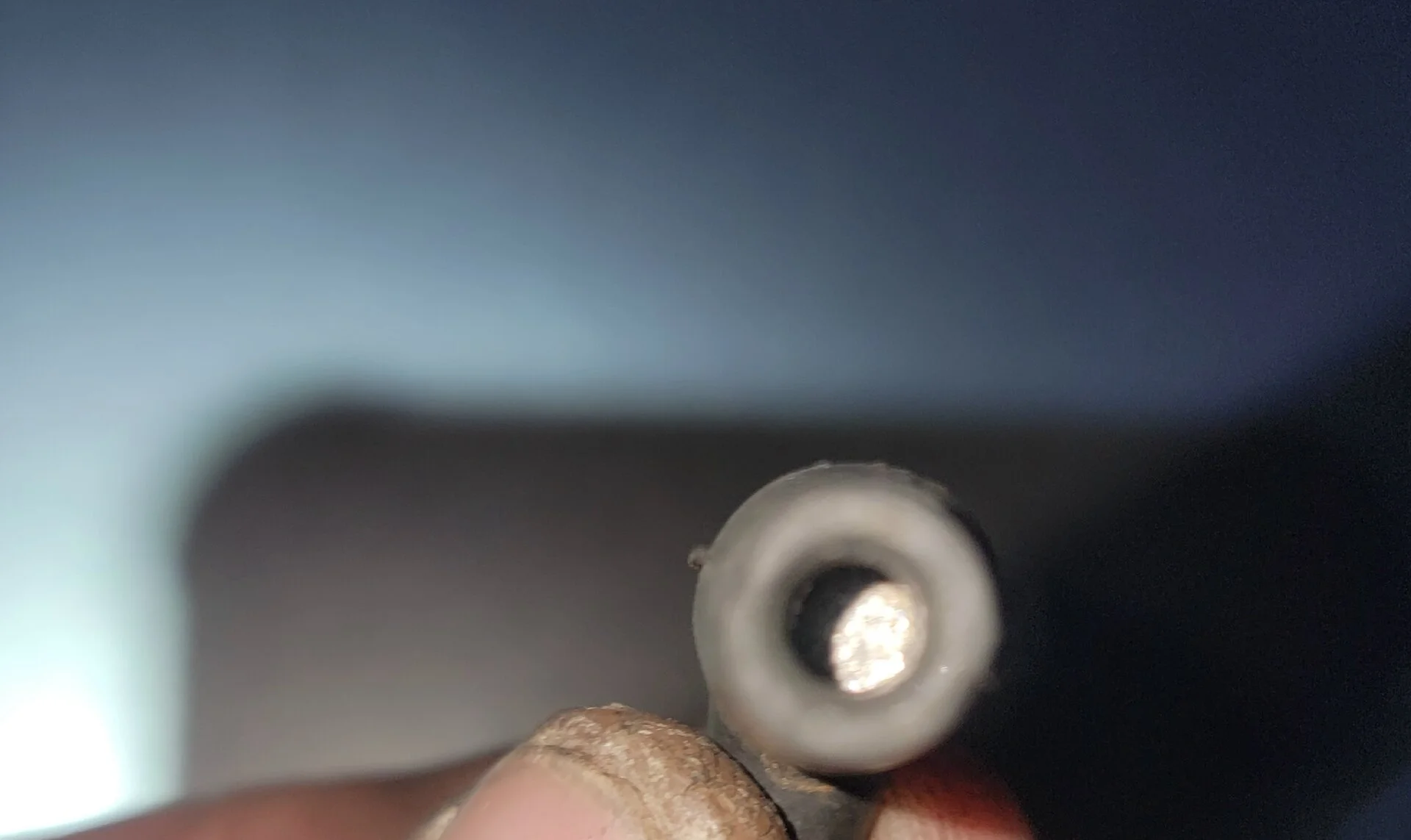

I till my fuel pressure regulator line off cause I'm having issues with it running right and I look at the line and it has a metal tab in it did something brake or does it come like that
the car hasn't been running right since I pulled the EGR emissions lines since I took out the smog I thought all of that could go watching YouTube and I have a delete plate I just can't get the right route to everything the pic I see is different then it was ran and it's my first mustang u will see my post I. clueless to these cars
You need a new FPR. Removing the emissions stuff may have caused a vacuum leak. Check all of your vacuum lines.
that piece was in the intake part and I've been trying all week to fix the vacuum lines but I had no clue that was in there I've been going crazy trying to figure it out it looks so simple but do any lines tee back anywhere I have the diagrams and a repair manual on it's way
You need a new fuel pressure regulator if that vacuum tit / nipple broke off of it

I'm not sure if came from anything on the car nothing is broken and I got a ton of vacuum lines at the junk yard and I'm not sure If i put it on to replace the line what color should the line be to the fpr and my phone autocorrect everything I see why my post don't make sense
The FPR vacuum line is red plastic with a 90 degree rubber end on it
So your Fuel pressure reg is not missing it's tit? Great!
I do not know where your broken little piece of metal line came from
Hook up the egr and see how it runs. Then try to shiit the system and run less

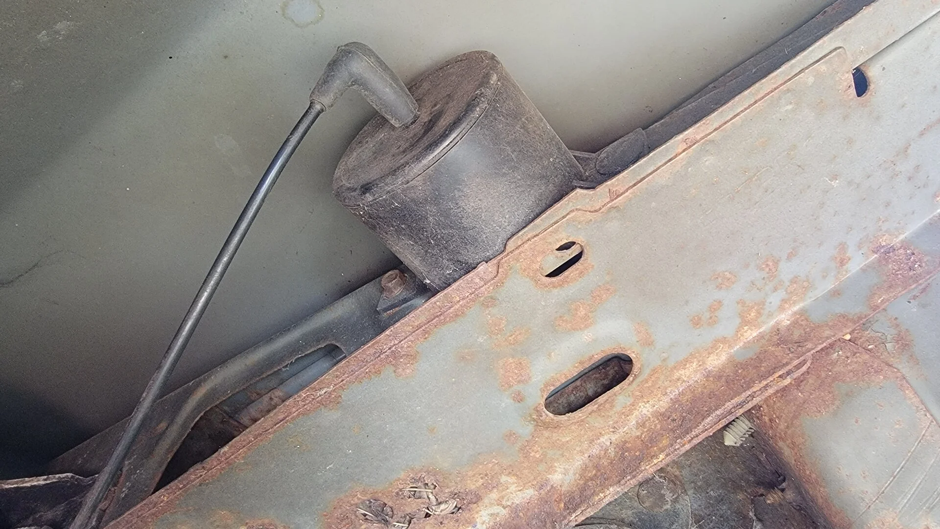

I still have to make sure I have the lines ran right the 2 that give me the most problems are the 2 connected to the canister in the middle of the frame behind the plastic liner
