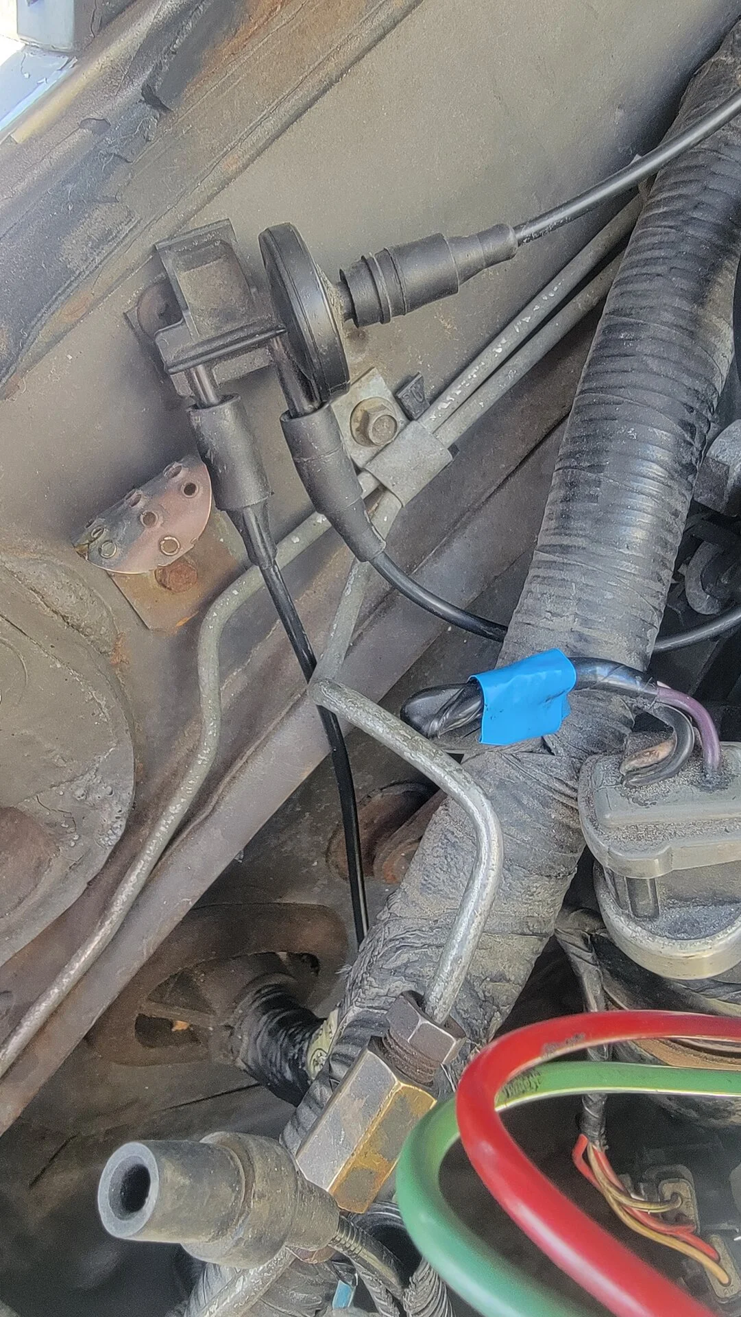

I have that but I try to hook everything up past where smog was and I'm not sure if it runs to a vac port then tees back into another line so many ppl have it missing I have a block plate and a EGR plug I'll show u how I have it ran but I have nothing plugged into the bottom ones

That can in the pic is a vacuum reservoir, it is for the ac/heat system, you should have a vacuum tree with several nipples, one has A/C above it, a line goes across the firewall to a check valve with two more nipples, one to the can you see in the pic, the other through the firewall into the cabin. They should be black.
The vacuum line for the fuel pump regulator comes from the back of the intake to the regulator.
Please use some punctuation in your posts, one continuous sentence is hard to understand.

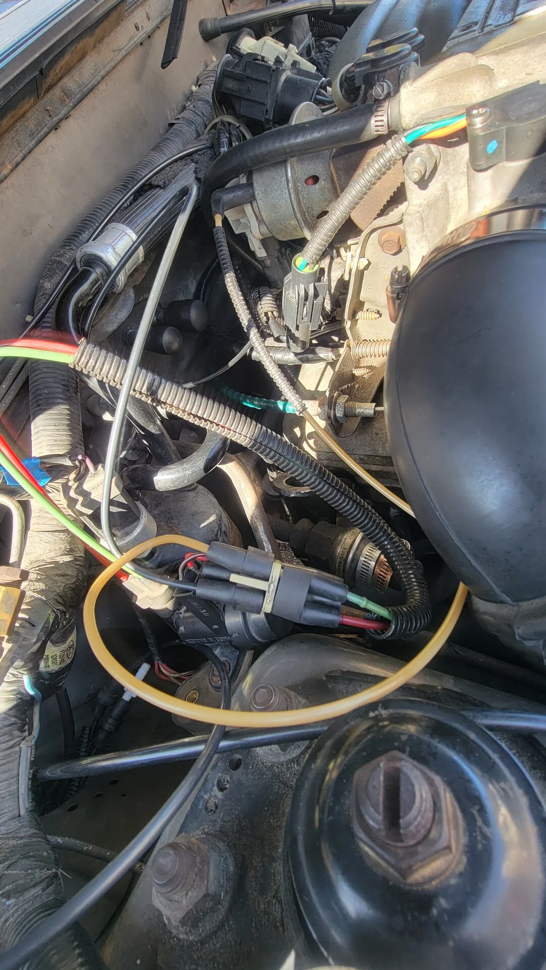

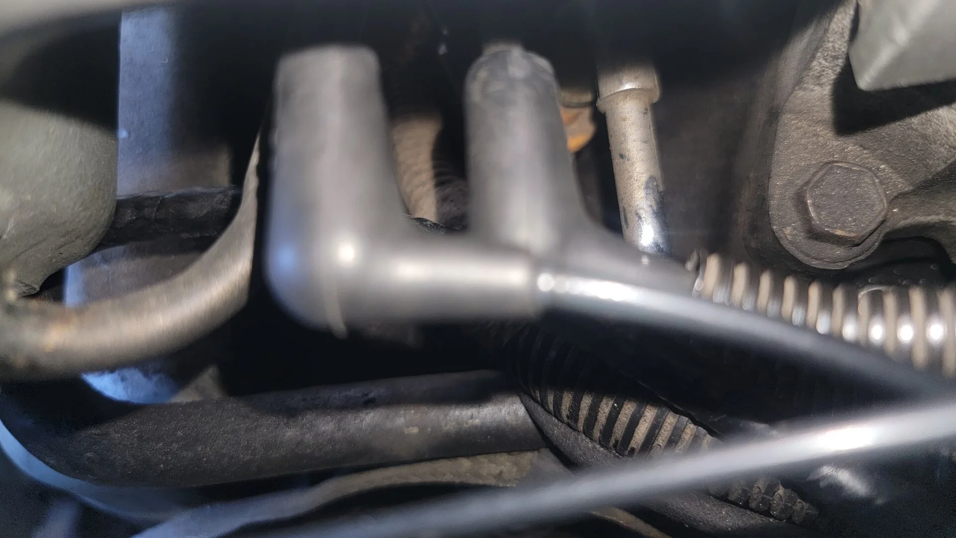

yes I'm sorry I need to re read my post, so I have the ball and another one by the air box, I have the line hooked up to the little tree here and which one is it I have the brake vacuum then above it I have 1 then right below it I have another what's on top so I know the bottom one

I'll have to get my book out later to see when I get back to the garage, those vac lines on my car are being redone on my car too, if you cap that nipple on the tree it will have no effect on how the car runs until I look at the book.
