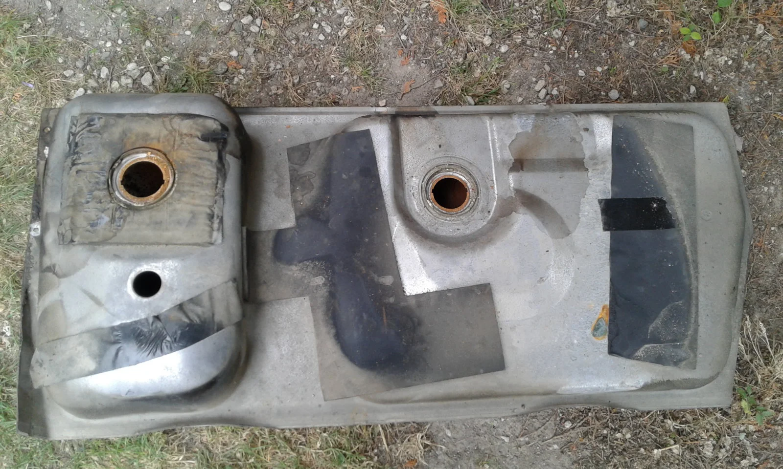

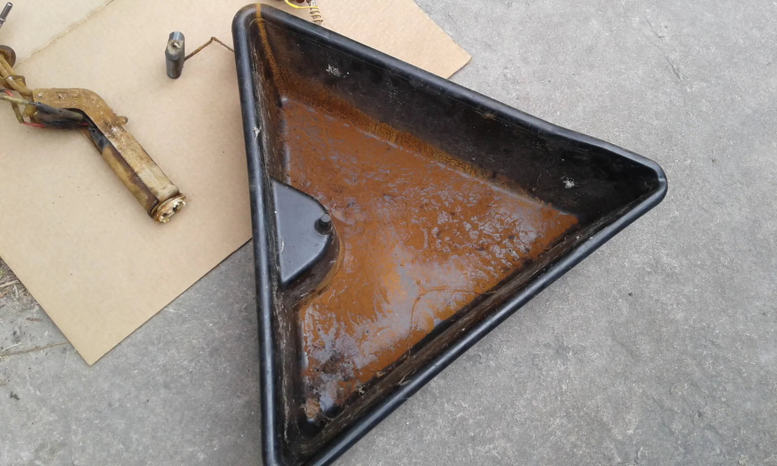

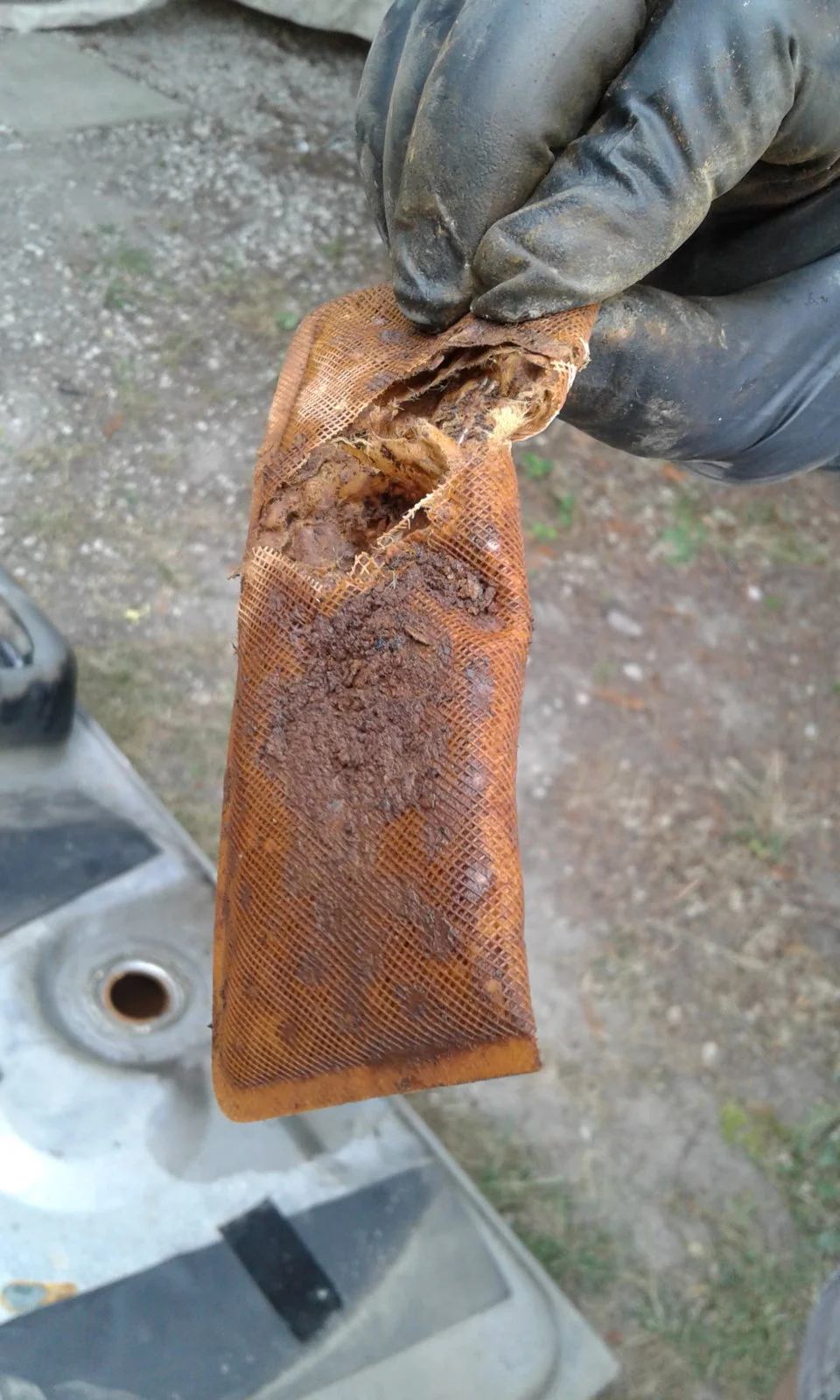

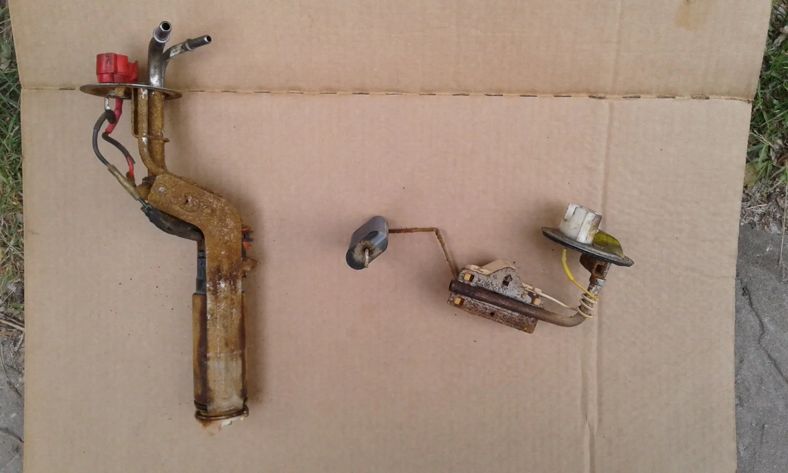

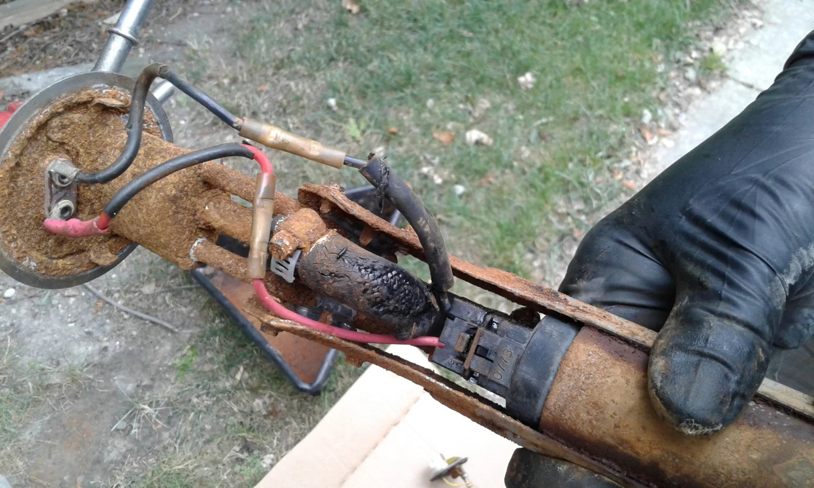

Well, I dropped the tank today, and found what I think is the problem.
It would appear the inside of the tank is extremely rusty, and the scale has clogged the fuel pump strainer.
Hard to believe the inside is so bad, since the outside looks so good.
It looks I will be ordering a bunch of new parts tomorrow.
Thanks for everyone's help.
Does anyone know what size of fuel pump hanger I need ? The parts websites list one with 5/16 lines and the other with 3/8.

More so with cars that sit for extended time. (Taking about the rust and the fuel meter not working.) Ethanol in todays fuel absorb moisture like a sponge
Measure your fuel outlet for the size but I believe it will be the larger one.
I use ethanol fixer , Enzyme stuff from Star chemical. Im sure my tank does not look good. What would one do instead of new, flush and dump.
Ya, I was surprised too!
I guess I should have kept my tank topped up, but the car was literally parked for over 10 years, and I had it stored on a lift, so it was not convenient to start, and I got lazy and forgot about it, even though I walk past it every day.
Funny thing is that when I started it for the first time in the spring, in over 5 years, it fired right up and idled smooth.
I guess I now have to play catch-up on the past 30 years of maintenance that I overlooked since it wasn't on the road.(excluding oil changes and coolant changes)
It goes to show you that sometimes it's the age and sometimes it's the mileage that wears out the parts.
Also, the Intake of the pump had a piece of pump strainer in it, combined with the dirty strainer, I would assume that this is why the motor wasn't getting fuel above 2000 rpm under load.
I also changed my fuel regulator back to the stock one, since the BBK one was leaking.
General do you know what the outside diameter of the pump hanger line should be ? Looking at LMR they only sell one pump hanger and its a 5/16. It's just that autozone lists both a 5/16 and a 3/8.
