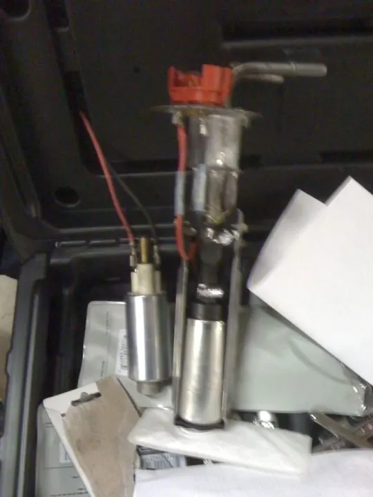

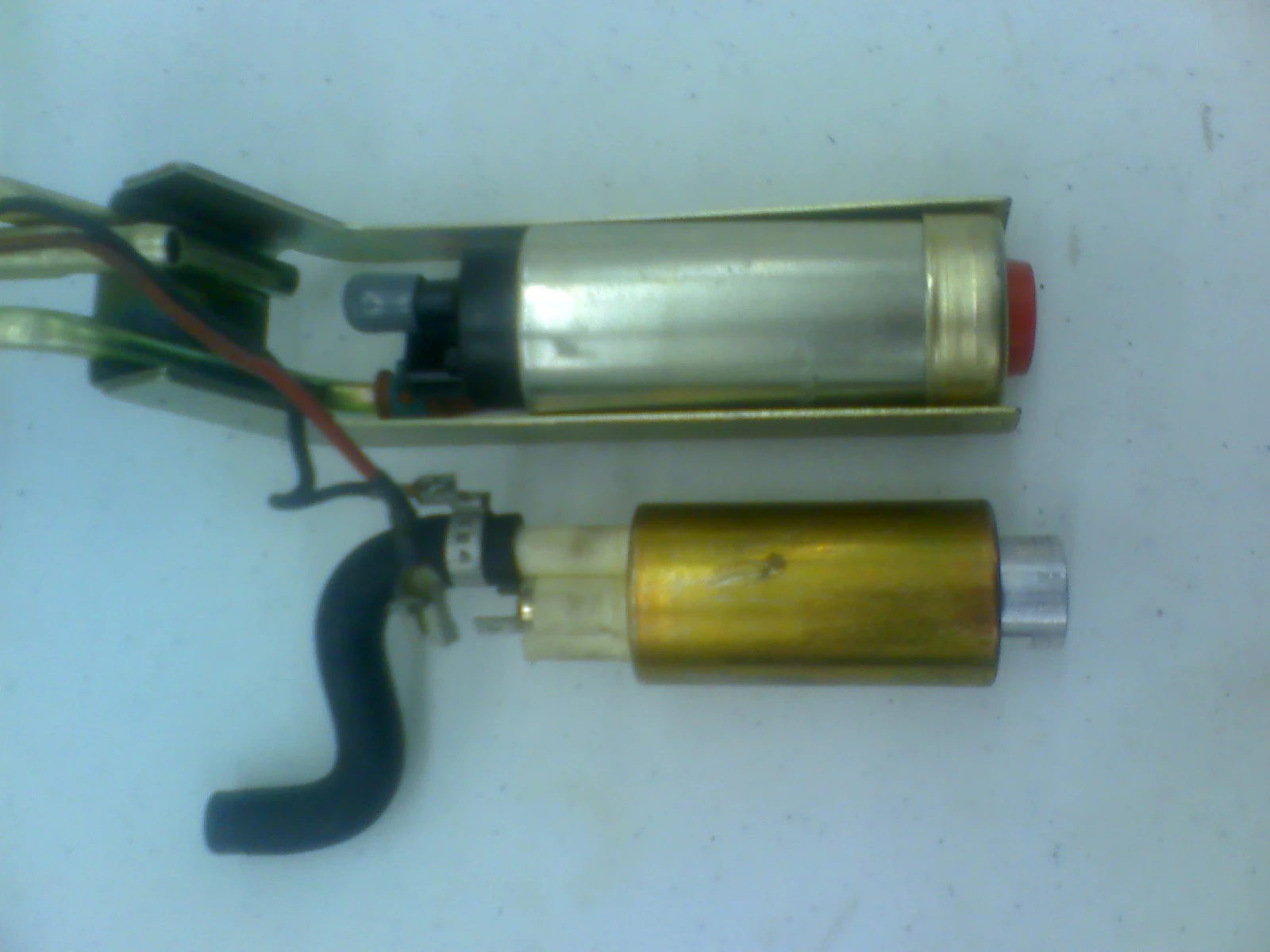

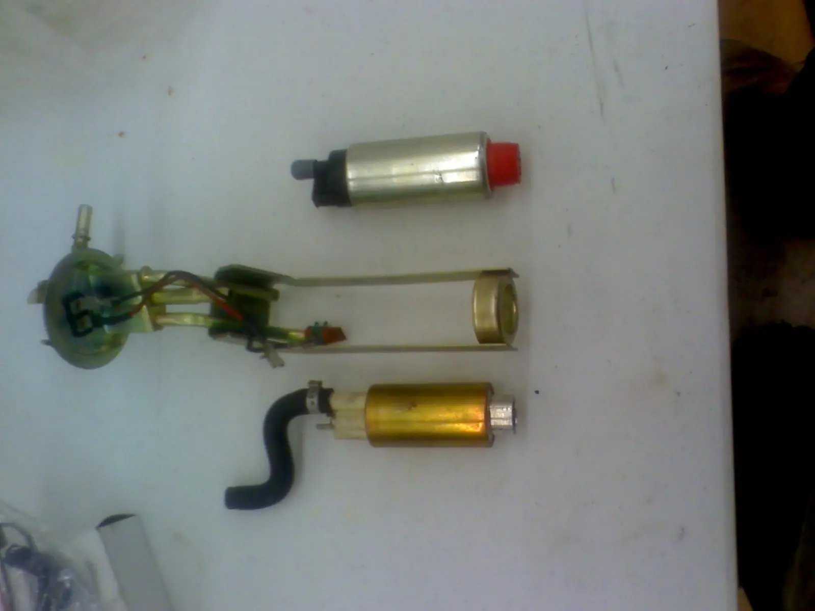

I am putting a Walbro 255 LPH fuel pump in my 92 mustang GT. The Walbro is slightly larger in diameter than the old pump. Therefore, the new pump will not fit the stock fuel pump bracket. Has anyone ever ran into this? I would apperciate any suggestions on what I need to do to get the new pump in.

my pump was like that also, i think it may be an aftermarket pickup...all i did to get the pump to fit in is cut one side of the ring around the bottom and spread it open a little... with the hose connected it sits in there really nice... i've ran a few different pumps that way with no issues...

I brought the bracket to work and got the guys in maintenance to strech it for me. They heated it up with a torch and then drove a larger pipe into the cup. The spot-welds that held the cup to the bracked broke while they were hitting it with a hammer. After streching it, they sent the bracket to our tool shop to have the cup spot-weled back on the bracket.
