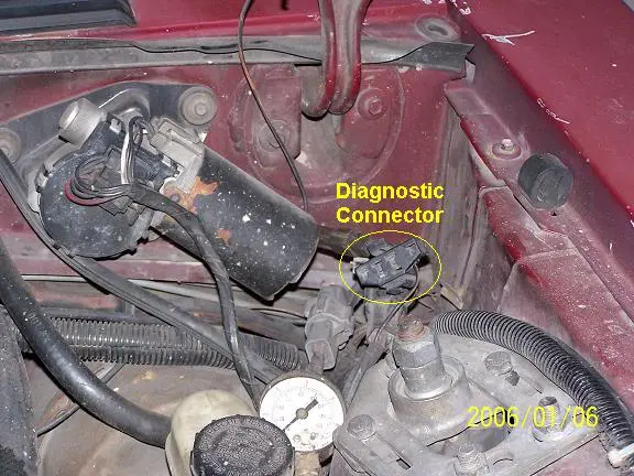

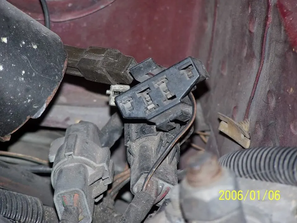

Clue – listen for the fuel pump to prime when you first turn the ignition switch on.
It should run for 5-20 seconds and shut off. To trick the fuel pump into running,
find the ECC test connector and jump the connector in the upper RH corner to
ground.
find the ECC test connector and jump the connector in the lower RH corner to
ground.
attachment.php
This was initially a bit confusing to me when I first looked at it. In the provided picture, it's the connector in the top right corner (the one labeled FUEL PUMP TEST POINT) that you short to ground to make the pump run continuously... correct?
I'm not sure what the, "lower RH corner" is referring to.
Fixed it, thanks for the heads up.
