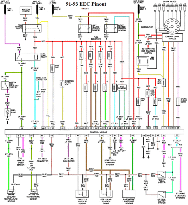

See the following website for some help from Tmoss (diagram designer) & Stang&2Birds (website host) for help on 88-95 wiring Mustang FAQ - Wiring & Engine Info Everyone should bookmark this site.
Ignition switch wiring
Complete computer, actuator & sensor wiring diagram for 91-93 Mass Air Mustangs
http://www.veryuseful.com/mustang/tech/engine/images/91-93_5.0_EEC_Wiring_Diagram.gif

Code 96 causes & tests 91-93 models. – KOEO- Fuel pump monitor circuit shows no power - Fuel pump relay or battery power feed was open - Power / Fuel Pump Circuits. The fuel pump circuit lost power at one time or another.
Look for a failing fuel pump relay, bad connections or broken wiring. The fuel pump relay is located under the Mass Air Meter on Fox bodied stangs built after 91. On earlier model cars is under the passenger seat. On Mass Air Conversions, the signal lead that tells the computer that the fuel pump has power may not have been wired correctly. See Mustang Mass Air Conversion | StangNet
Diagram of the fuel pump wiring for 91-93 cars.
attachment.php
Look for power at the fuel pump - the fuel pump has a connector at the rear of the car with a pink/black wire and a black wire that goes to the fuel pump. The pink/black wire should be hot when the test connector is jumpered to the test position. To trick the fuel pump into running, find the ECC test connector and jump the connector in the lower RH corner to ground. No voltage when jumpered, check the fuel pump relay and fuse links.
attachment.php
Power feed: Look for 12 volts at the pink/black wire (power source for fuel pump relay). No voltage or low voltage, bad fuse link, bad wiring, or connections. Remember that on 92 or later models the fuel pump relay is located under the Mass Air meter. Watch out for the WOT A/C control relay on these cars, as it is located in the same place and can easily be mistaken for the fuel pump relay.
Relay: Turn on the key and jumper the ECC test connector as previously described. Look for 12 volts at the dark green\yellow wire (relay controlled power for the fuel pump). No voltage there means that the relay has failed, or there is a broken wire in the relay control circuit.
attachment.php
91-93 Models:
Using the diagram, check the dark green/yellow wire from the fuel pump relay: you should see 12 volts or so. If not the relay has failed or is intermittent. Check the inertia switch: on a hatch it is on the drivers side by the taillight. Look for a black rubber plug that pops out: if you don't find it, then loosen up the plastic trim. Check for voltage on both sides of the switch. If there is voltage on both sides, then check the Pink/black wire on the fuel pump relay: it is the power feed to the fuel pump. Good voltage there, then the fuel pump is the likely culprit since it is getting power. No voltage there, check the Pink/black wire, it is the power feed to the fuel pump relay & has a fuse link in it. Good voltage there & at the dark green/yellow wire, swap the relay.

I started taking a look at some of the troubleshooting.
Of note, when I was jumping the EEC, I was able trick the fuel pump on just briefly one more time, but I wasn't able to replicate.
Moving to the relay itself.
With the key on and the jumper in, at the relay, I have like 8.7 volts on the pink/black (which is the feed). I have like .5 on the dark green/yellow (which is the power from the relay to the pump).
Relay failing or working intermittently?
I took the relay from the WOT, which I have heard was the same (and then I also heard that it wasn't), and placed it in the fuel pump relay and there was no change.
If I have power to that relay, that fuseable link is good, right?
Getting really cold here in NY, so I'm not sure if my battery is starting to need a boost, which may make this more complicated for me.
More importantly....I think I can only count on my wife pushing this puppy out of the garage one or two more times for me to work on it :), but I'll get it done.
All testing is done with the ignition switch in the Run position. Do not forget this crucial step.
The pink/black wire s should have the same voltage as the battery positive terminal +/- 0.25 volt. If not, then the fuse link for the fuel pump has opened up.
With the test jumper in place the green/yellow wire should be the same voltage as the pink/black wire +/- 0.25 volt.
If not, look at the red wire: should have the same voltage as the battery positive terminal +/- 0.25 volt.
If not, then check the yellow wire on the EEC relay located on top of the computer. This one is hard to get to. It should have the same voltage as the battery positive terminal +/- 0.25 volt. If not, then the fuse link for the computer has opened up.
If the red wire does not have the same voltage as the battery positive terminal +/- 0.25 volt and the yellow wire on the EEC relay does, then check the red/green wire on the EEC relay. It should have the same voltage as the battery positive terminal +/- 0.25 volt. If not, then the ignition switch is defective or the fuse link in the ignition wiring harness has opened up, or the EEC relay is defective.
Ok. Trying to keep my head up, but I think I'm starting to think that I'm not going to be able to repair this myself.
I continued with the diagnostics, and here's what I got this morning.
Battery (key off) 11.38
Battery (key run) 10.38
Battery (key on w/jumper) 9.7
pink/black (w/jumper 7.55 to 7.68)
Battery (key run no jumper) 7.64
pink/black (key run no jumper) 7.60
green/yellow (key run w/jumper) 5.35
pink/black (key run w/jumper) 5.19
I left the car in run with jumper on for most of my troubleshooting, which I probably shouldn't have done in hindsight to conserve some power.
So I have my original EEC, and a tested refurbished one, and I'm also faced with a time crunch now bc if the issue wasn't the EEC, then I have to return the refurbished one soon.
I'm frustrated that I was able to jump EEC test and start and run the car no problem before, but as soon as I swapped the EEC, I wasn't able to essentially do anything anymore, and now the car won't even crank for me. Just venting.
Rob your piggy bank for a battery charger: hook it up and let it charge at least overnight. Low voltage is going to complicate your troubleshooting process. The computer and most of the other electrical stuff doesn’t work well once the voltage drops below 10 volts.
