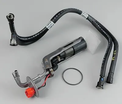

So I'm doing a fuel pump replacement and I noticed that the return line is just capped off as it sits above the actual fuel pump? My question is, and it might be a bad one lol, how does the fuel return if it's just capped off? Secondly, the old cap was rotted a bit and tore while I was inspecting it, so would it be safe to just throw a new cap on there and call it a day?
I'm talking about the 1/4" line into the fuel pump hanger deal if anyone's wondering, I assume this is the return line.

Seemed to run fine when it was and it's still got EFI on it. I was thinking it's possible that there was a separate return line, kinda loosely plugged into the tank sitting kinda away from everything else... so I guess I might be modifying my question to what is the smaller line off the fuel pump bracket for?

The smaller line is the return, so I'm sure you're right, that it's not connected. Is it possible that someone used a newer pump from, say an SVT Focus? The newer cars are variable speed pumps, on a returnless fuel system, so there may not be a provision for a return line.

How strange... hmm, well I'll leave it uncapped then, I assume this Walbro 255 is meant to be run like that. I'll check out that old pump tomorrow, see what's up.

The return line opens up just above the fuel pump and dumps the return fuel back into the tank. I think that there is supposed to be a rubber duck bill looking cap on the retun line inside the tank. It allows fuel to flow back in the tank, but closes when fuel tries to flow back up the return line. It is often missing or damaged, and you can run without it.
