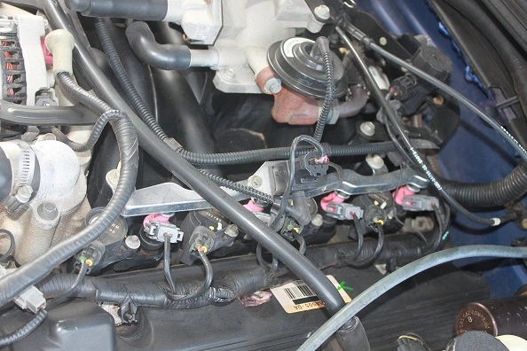

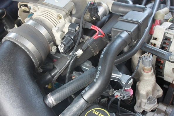

Start with the basics and work you way up. No need to get drastic and replace your fuel rails (although I highly doubt your rails are to blame). Would you mind posting pics of your current fuel rails? Also, if you have a recording camera or camcorder, a video of the issue would help the troubleshooting process.
