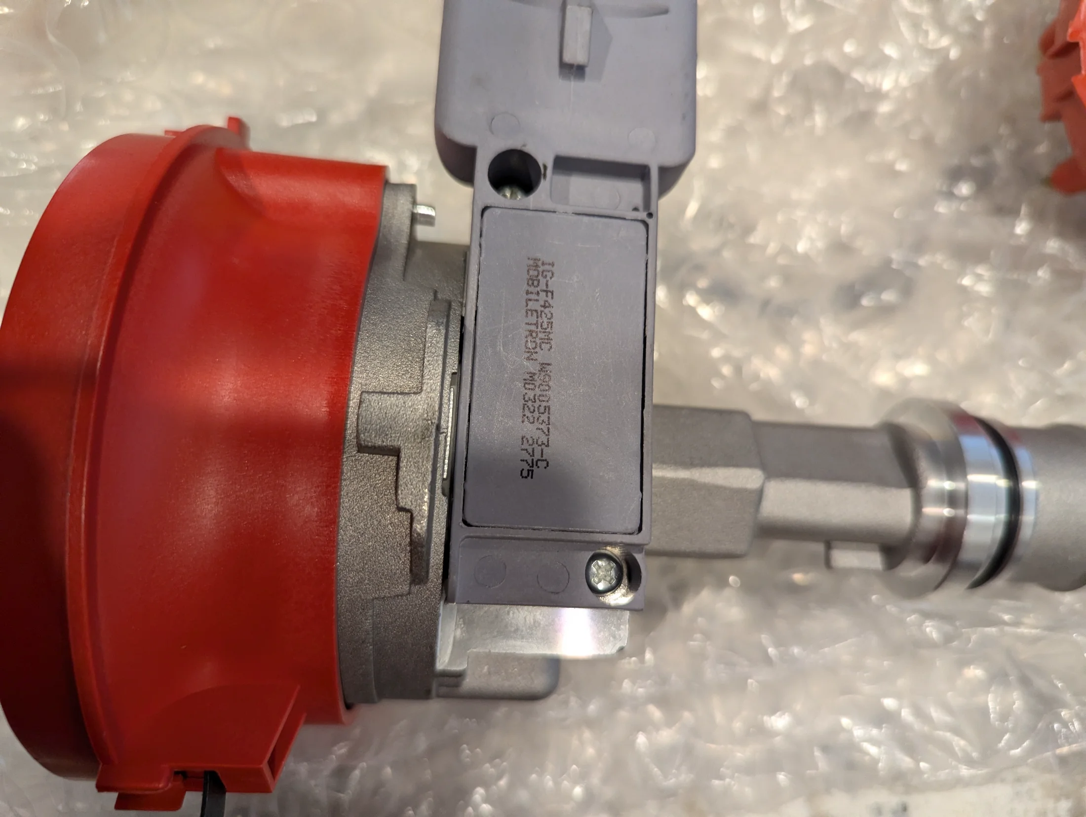

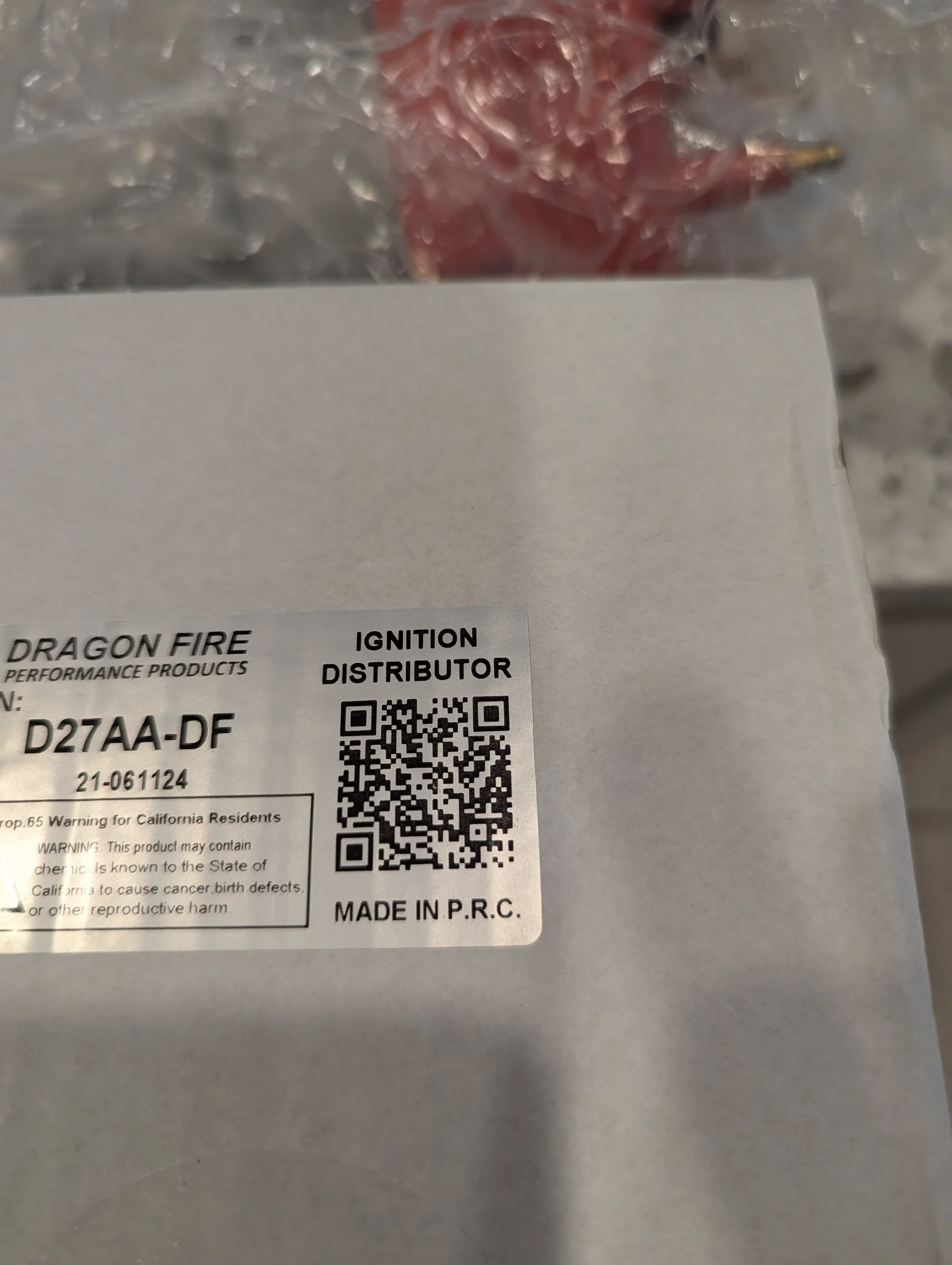

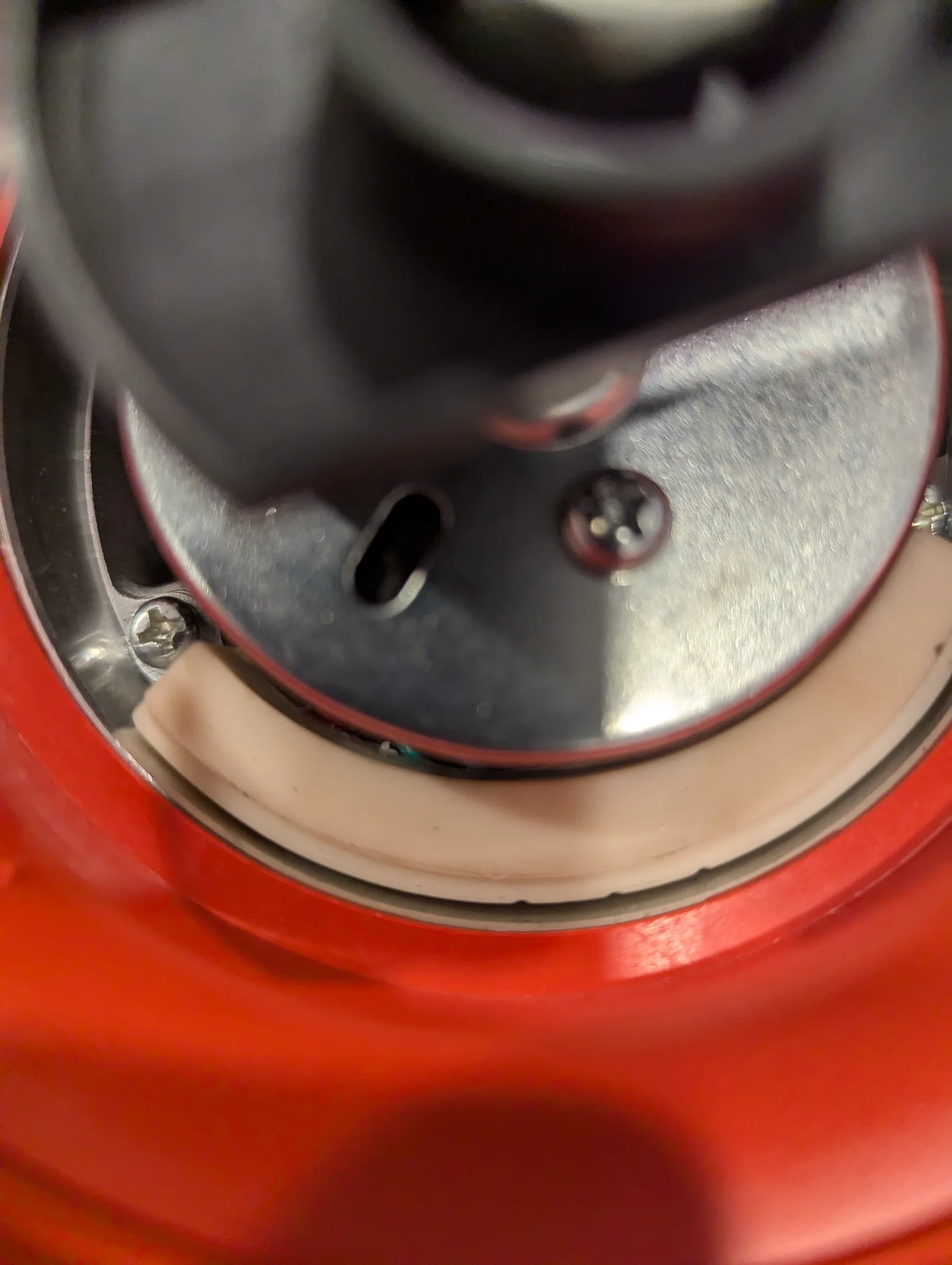

The dragon fire dist.and wires showed up from aip. Nothing on website where it's made. Clear in pic it's from the P.R
C. So another chiknee part. Noname tfi and white color pickup.
Fuggggg.

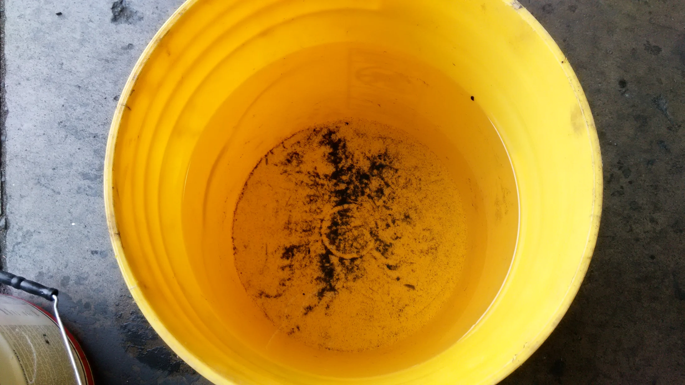

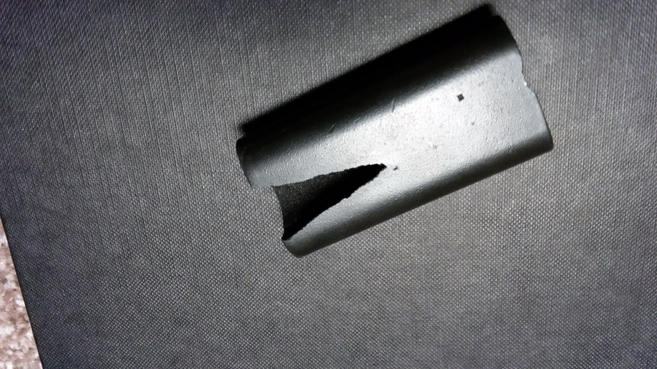

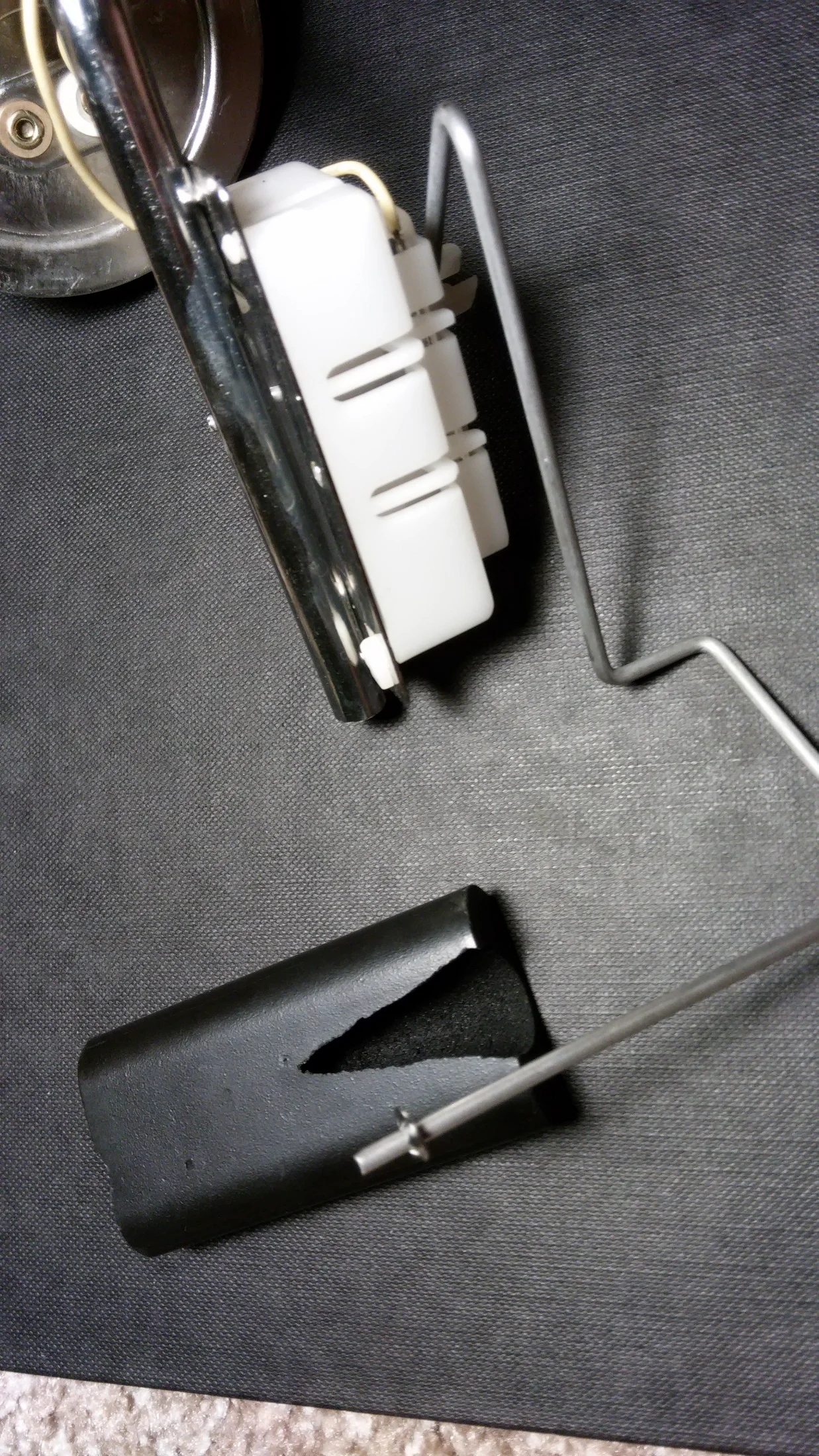

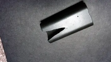

I wanted to add since i just remembered this but i also had a wonderful experience with 2 (two) gas tank sending units back to back, my gauge had gone south so i dropped the tank and installed a aftermarket Chinese sending unit,the float disintegrated so the gauge stopped working again so not only did i have to replace it but i also had to clean out my tank,right after that i started having these weird issues where my inertia switch was getting mighty toasty and the car would cut out and act strange.
I traced it to the tank and fuel pump,the pump was sucking the proverbial golf ball thru a straw in turn making the rest of the system work like a dog,those tiny particles from the first and second sending unit float had saturated the sock rendered it useless,i am including some pictures for your viewing pleasure,i ended up picking up a sending unit from Autozone (Spectra) and its been fine ever since,I'm sure Spectra is also Chinese but ive had a decent experience with them.
Both of these sending units were bought from our go to "speed shops" that we do business with all the time.
Fuggggg.
I put this in today? I figured if it works till I get the old ford one drilled and back on ill be ok.
It fit tighter then the O'Reilly's ones did and the TFI actually worked. Starts and doesn't hiccup, drives and doesn't stall, so off to work it goes with me Monday. Ill give updates daily. Staying home, calling off work, I gotta relax my old ass.
