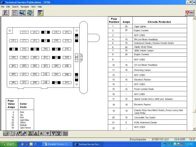

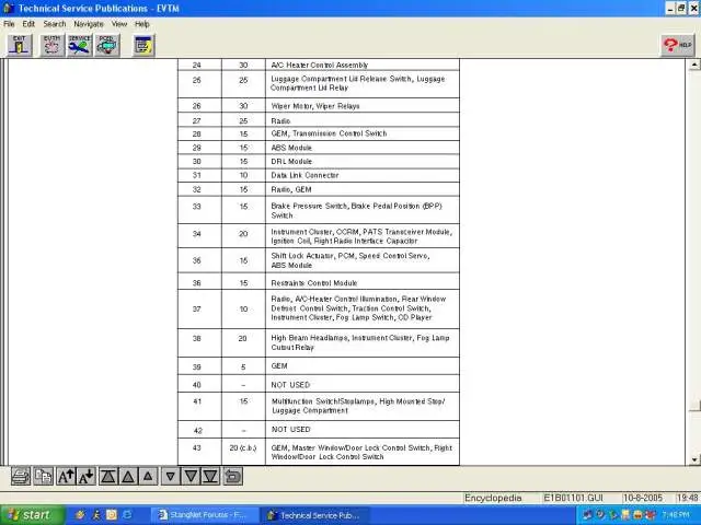

Anyone have a diagram that shows where each fuse goes and what amp it is? I think I have a fuse in the wrong place (don't ask how please :nonono: ) and that's resulting in my foglights not working. So I'd like to check the location of each fuse to ensure they are where they're supposed to be located. I don't have my owners manual or anything, any help would be appreciated! :nice:
See the attached thumbnails for the diagram.
It's missing fuse 23, which is 15 amps, A/C Heater Control Assembly, Rear Window Defrost Control Switch
Couldn't fit it on the screen. Had to shrink the images down a bit to upload them to here, so you'll have to save them, then zoom in to read probably.
