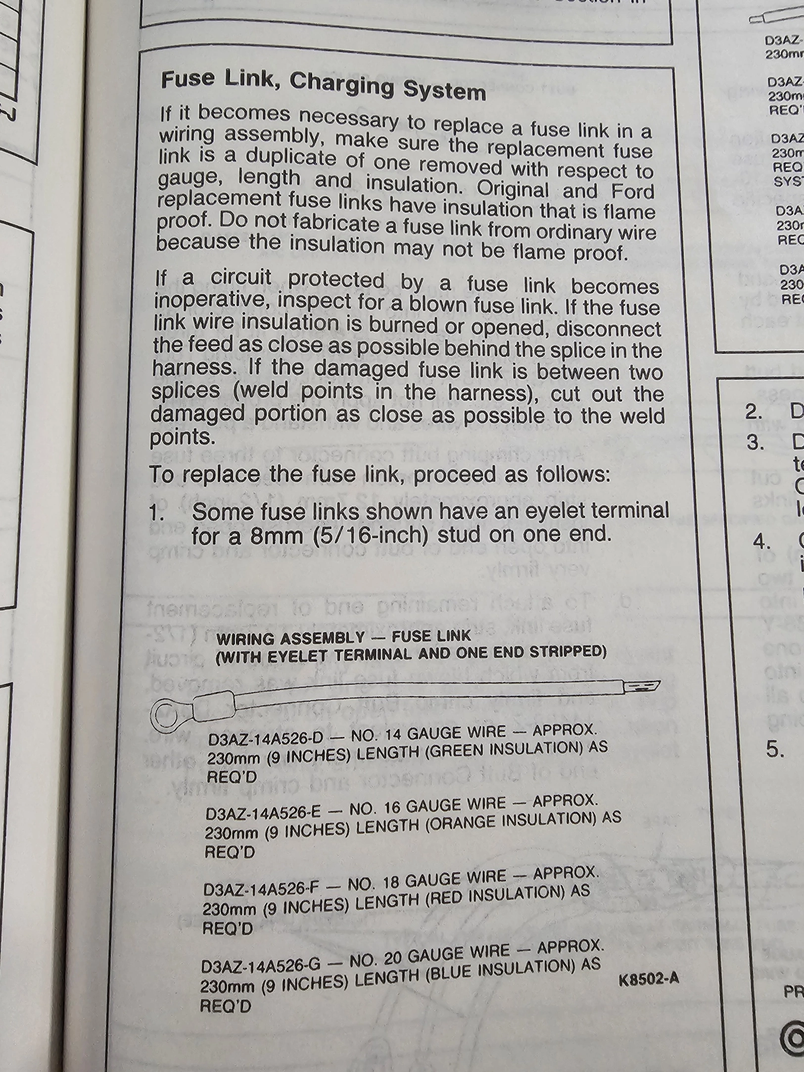

Hello, at my solenoid I have have 3 Fusible links I’d like to replace at the solenoid on my 1993 LX 5.0, the solid yellow, Black/Yellow and the Black/orange. What size new Fusible links do I need to solder in for these 3 wires? Thanks
