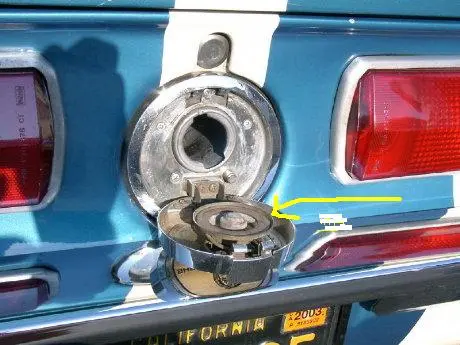

hello all im in need of the sealing assembly that seals a pop-open gas cap.The piece that seals the cap to filler neck is missing where can i buy replacement.See pic below,its the whole assy i need the spring/rubber gasket and retainer bolt.he Thanks javed
http://img.photobucket.com/albums/v403/boss_302/shelbygascap.jpg

Also, most repro pop-open caps come with a regular cap to use under the pop-open part. It is not recommended to use that setup because it did a poor job of sealing. The caps come with the parts you are talking about but are unassembled and recommended for show cars only.
I just put the pop-open cap assembly on the convertible and didn't use the parts you're talking about due to the aforementioned safety concerns -- it just doesn't seal well and I guess there were some leakage/fire? issues back in the day. It's not recommended to rely on that mechanism for sealing on a car that will be driven.
Anyway, if you still want the parts, I have them. Email me.
