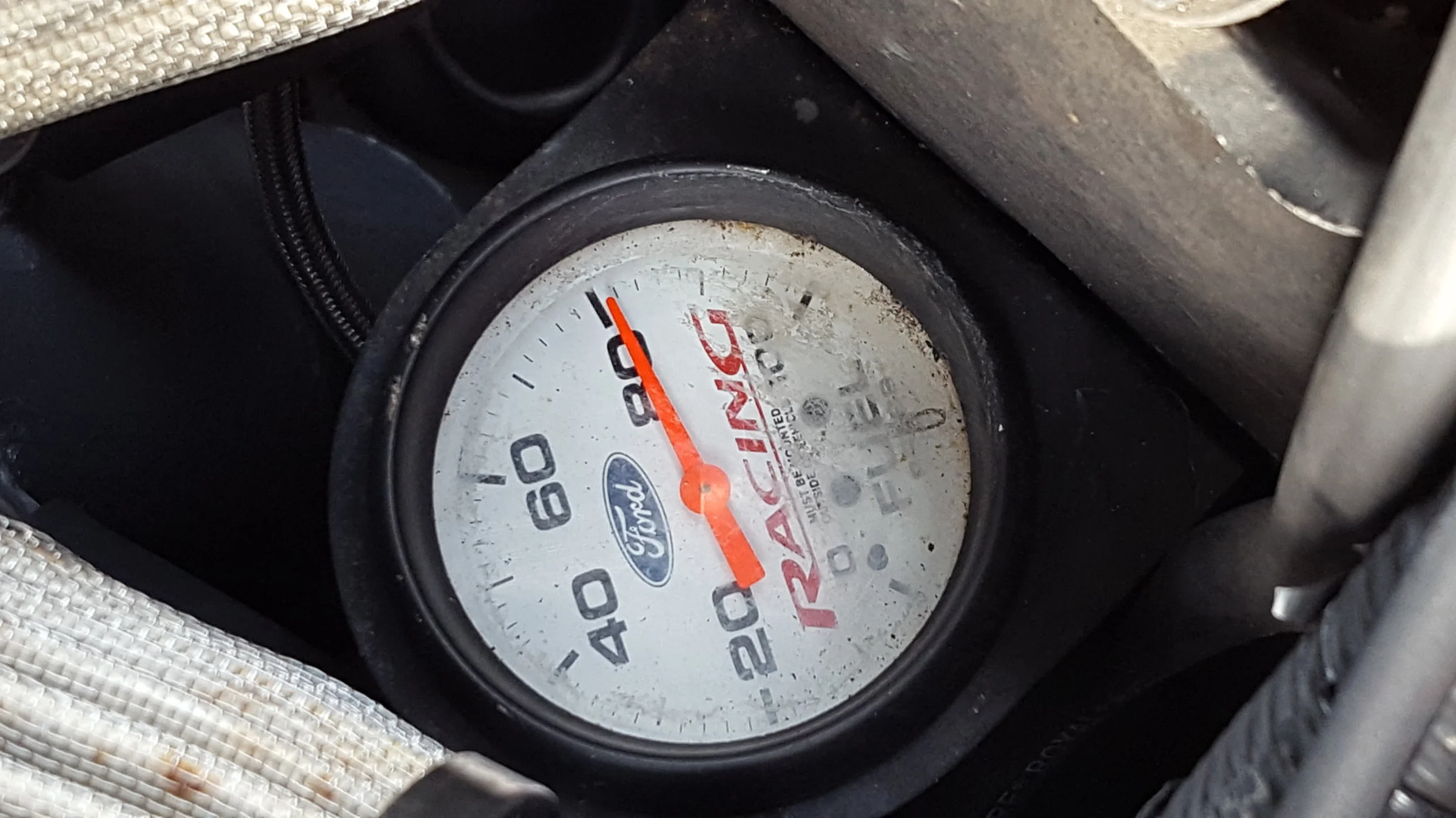

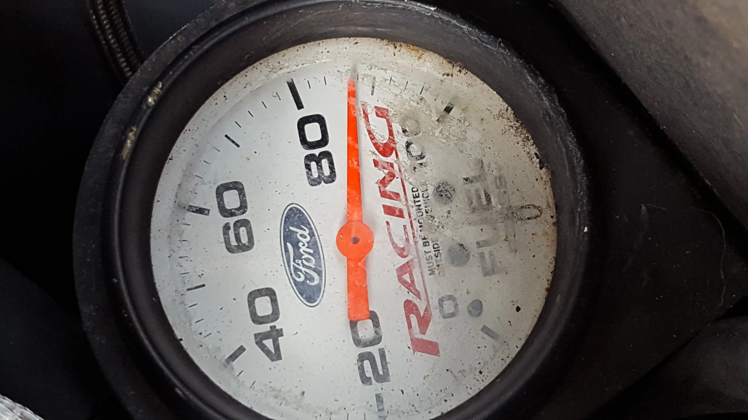

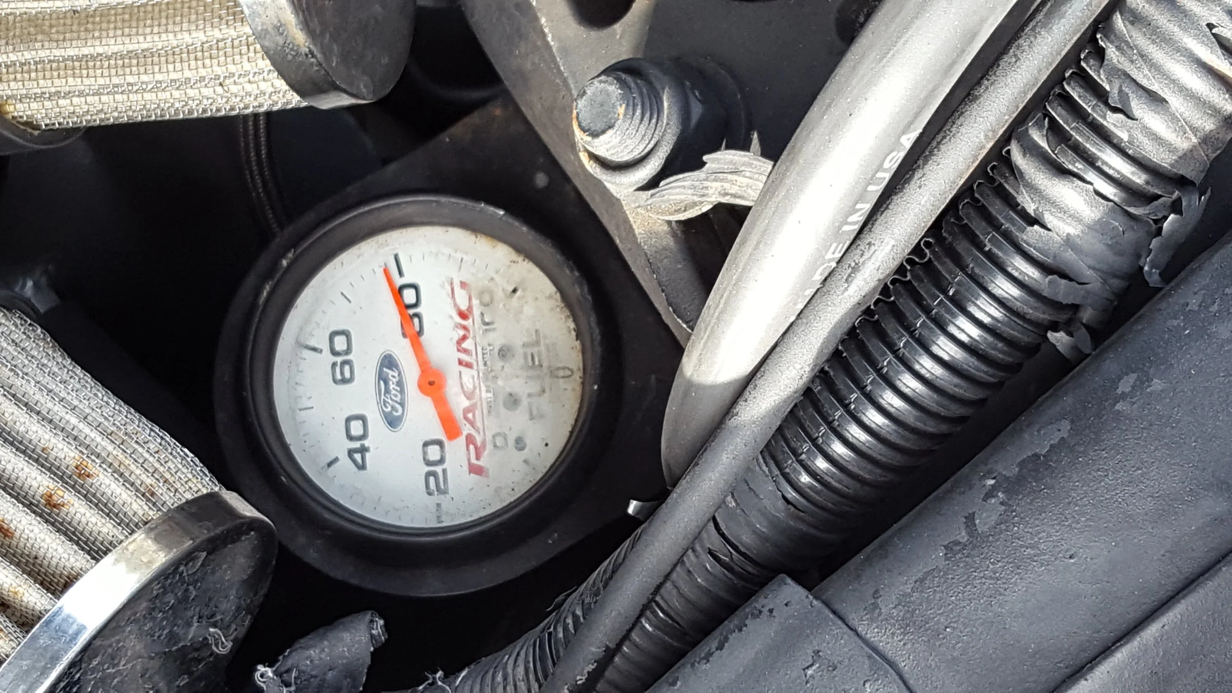

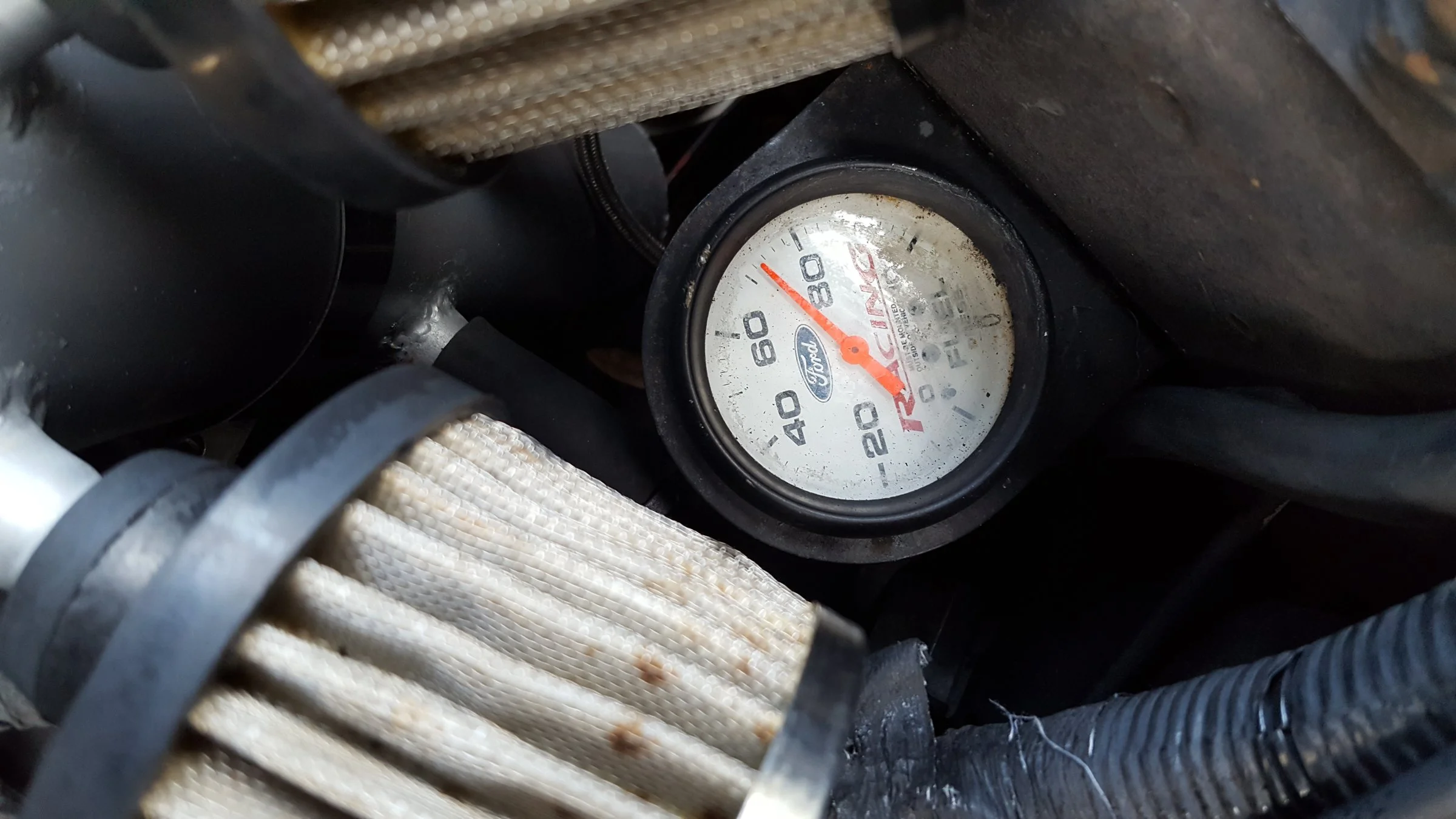

Well I'm almost 30 min in to my injector leakdown down test. not sure what pressure they needed to be tested at so I just clamped the return line and primed the pump a few times.
Wow almost 85psi on the rails.
set a timer for 10 min then snapped this one.
20 mins later.....
30...
I never did clamp the feed line sooo.... I guess this could be leak back into the tank. somehow I doubt it's the injectors though....
