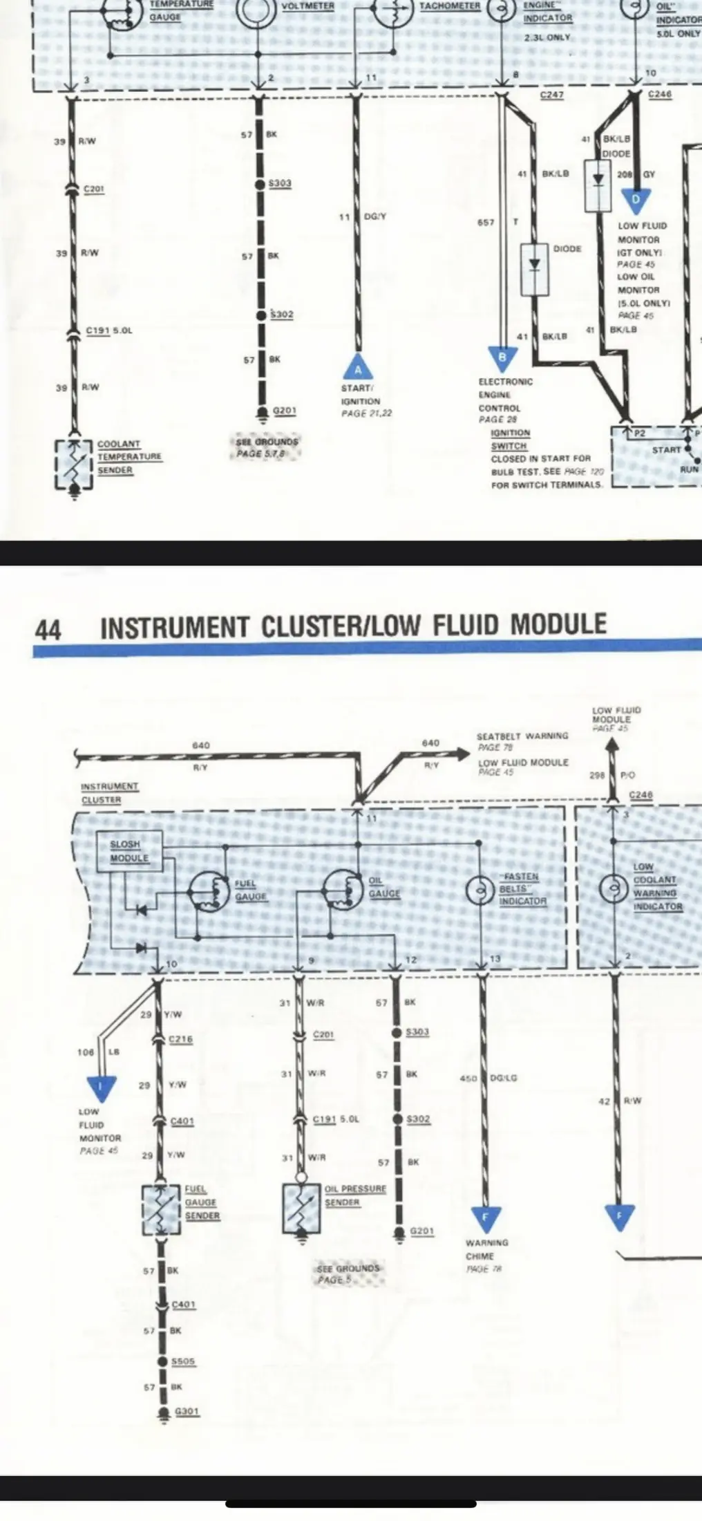

I know the 90 and up have the anti-slosh module but I am pretty sure the 87-89's have this and it affects multiple instruments:
  • Useful
Reactions: General karthief
Thank you!!! And this is located on the back of the cluster correct?
Slosh module only affects gas and oil pressure on 87-89
