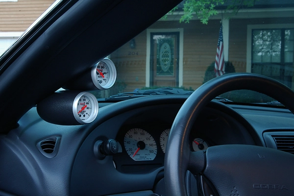

I have this one installed on my ride looks great.
On old car
