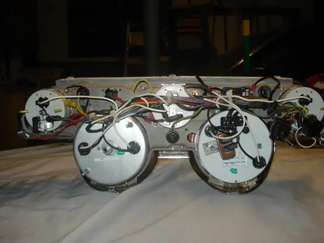

This is my take on the situation; The speedometer works because it is mechanical and has no electric hookup to work or not work. Your gauges that work are aftermarket guages that probabaly require 12 volts that have been hooked up to a 12v source either from the fuse box of direct to battery. The gauges are new as well as the wiring that goes with them (probably) and maybe even the sensors.
The gauges that don't work are the origainal ones. So my GUESS would be that the voltage regulator that is supplying power to the original gauges is bad (a $15 part from your local parts house). THe voltage regulator I believe supplies 8V of power to the gauges. Replace that and see what works.
The voltage regulator is the small brown rectangular device shown on the large gauage on the right and has two wires running to it.
the part is actually about 25-40 bucks and the soldered tabs break of real easy(cheap part). Go to radio shack and make your own.They sell voltage regulators for about 3 bucks and you want one that steps the voltage down to about 5 volts
