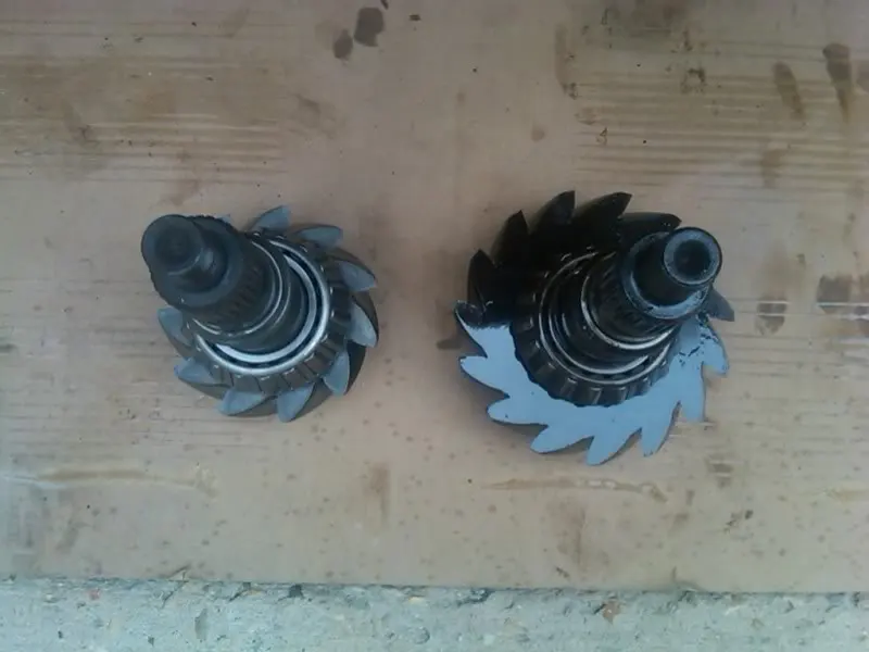

I got a used set of 3.73 gears from a guy on ebay. Jacked the car up and got started. I've never done a gear swap so you can imagine my surprise when I pulled the 2.73 pinon and set it next to the 3.73.
All went well, all specs were good, no issues, no clunks no whine or roar. Backlash was .012". Gear pattern was perfect, just a little to the toe on the drive side of the ring gear. I did manage to pinch the hell out of my finger while putting the ring and trac-lok unit back in:mad: I also chunked the dogbone.

The dog bone as it is called, is a vibration dampener. With the driveshaft spinning faster with 3.73 gears, it and a perfectly balanced drive shaft play a big part in having a driveline that doesn't shake itself apart.
