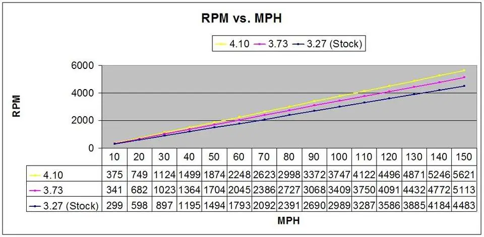

Go with 4.10's
Here's the numbers I have with 4.10's

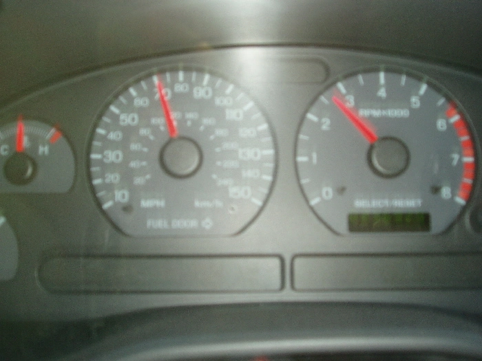

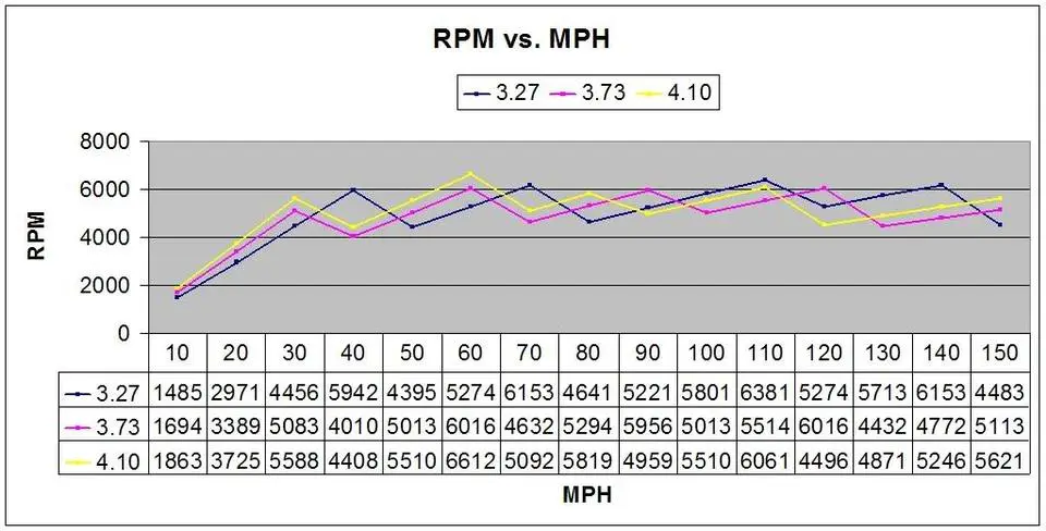

I did not make these, I just saved the pictures. Someone else from here made them so props to him
