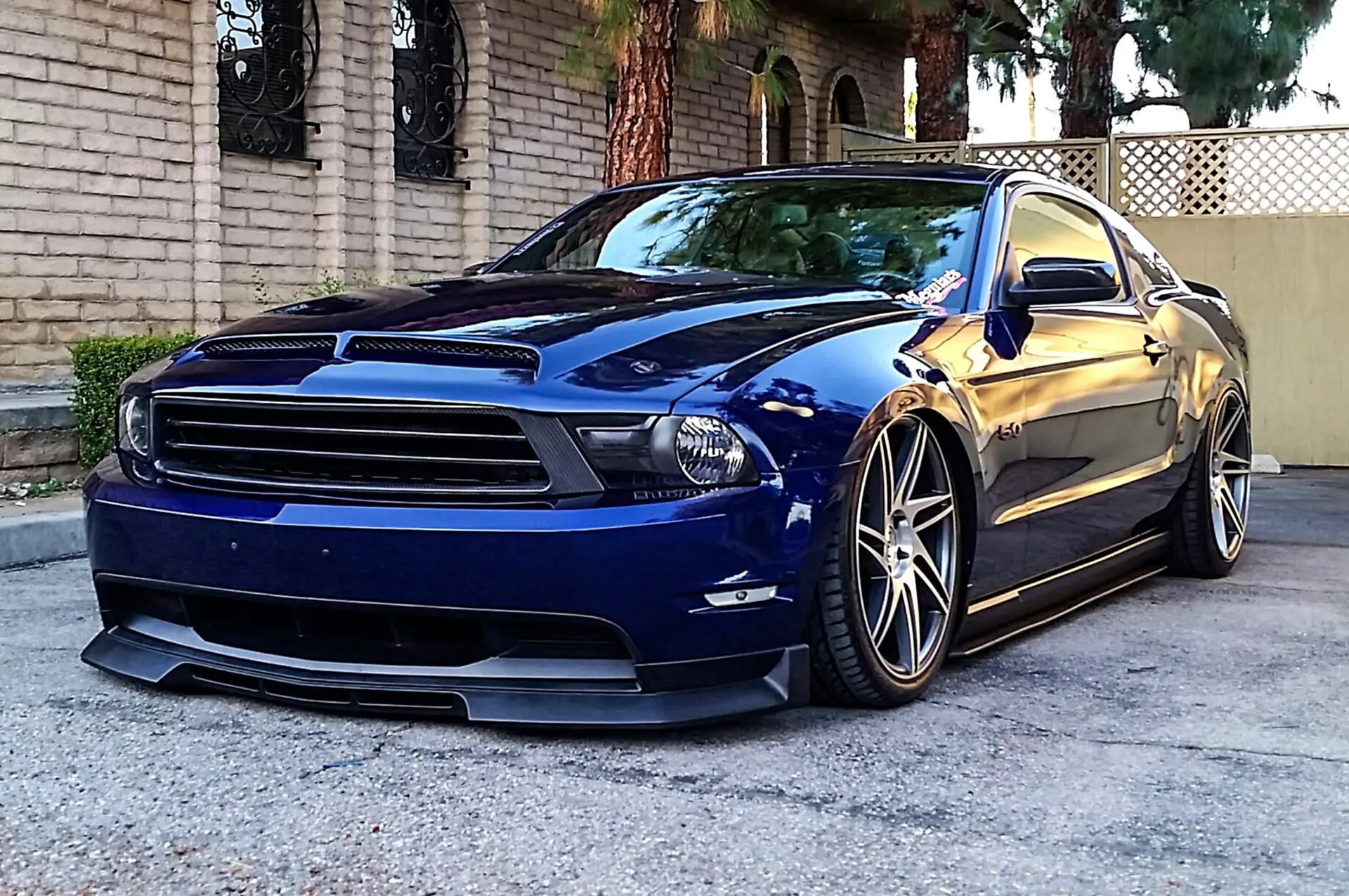

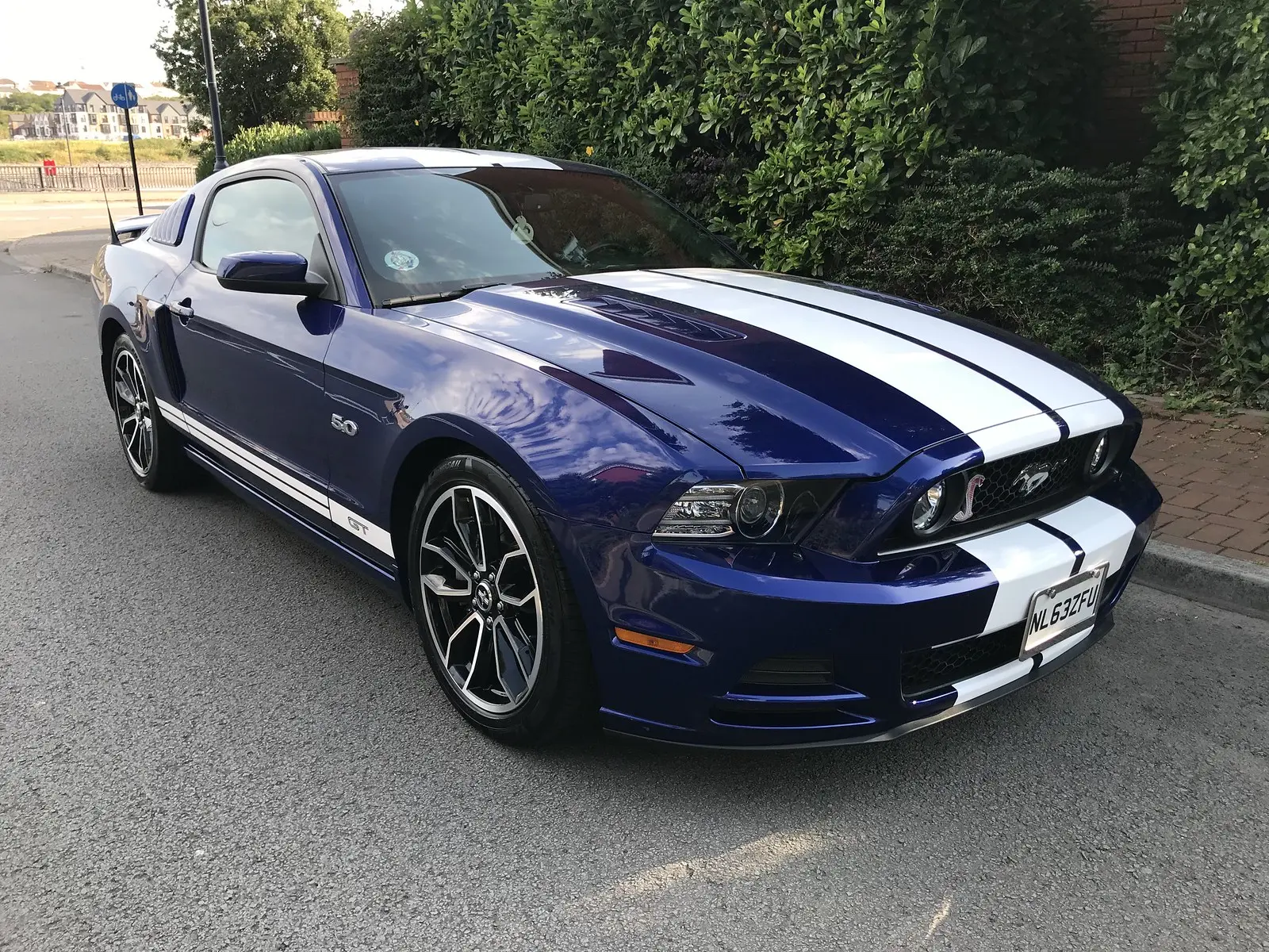

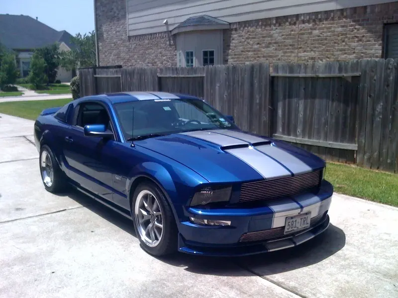

You can make all the power you need+ outta that motor. Don't let your buddies talk you into foolishness. They all have transmission envy and this:
It's all about the grill. O_o
