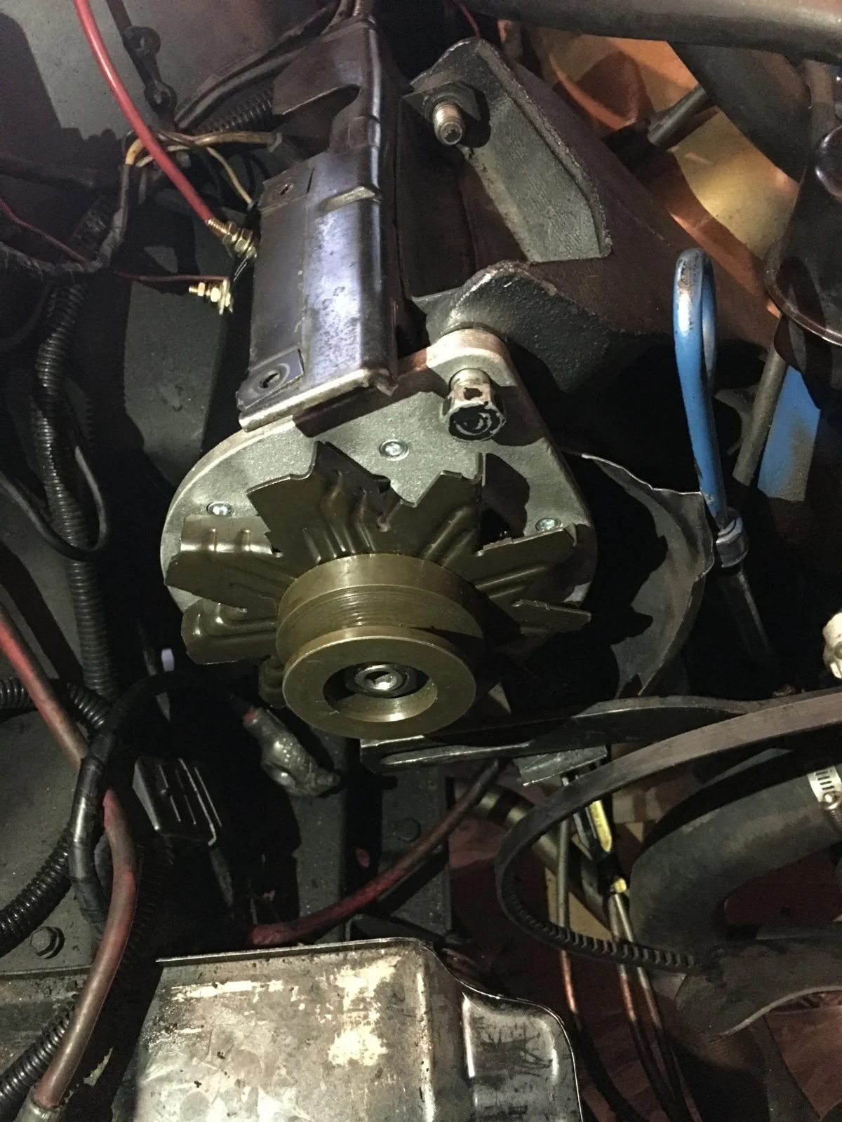

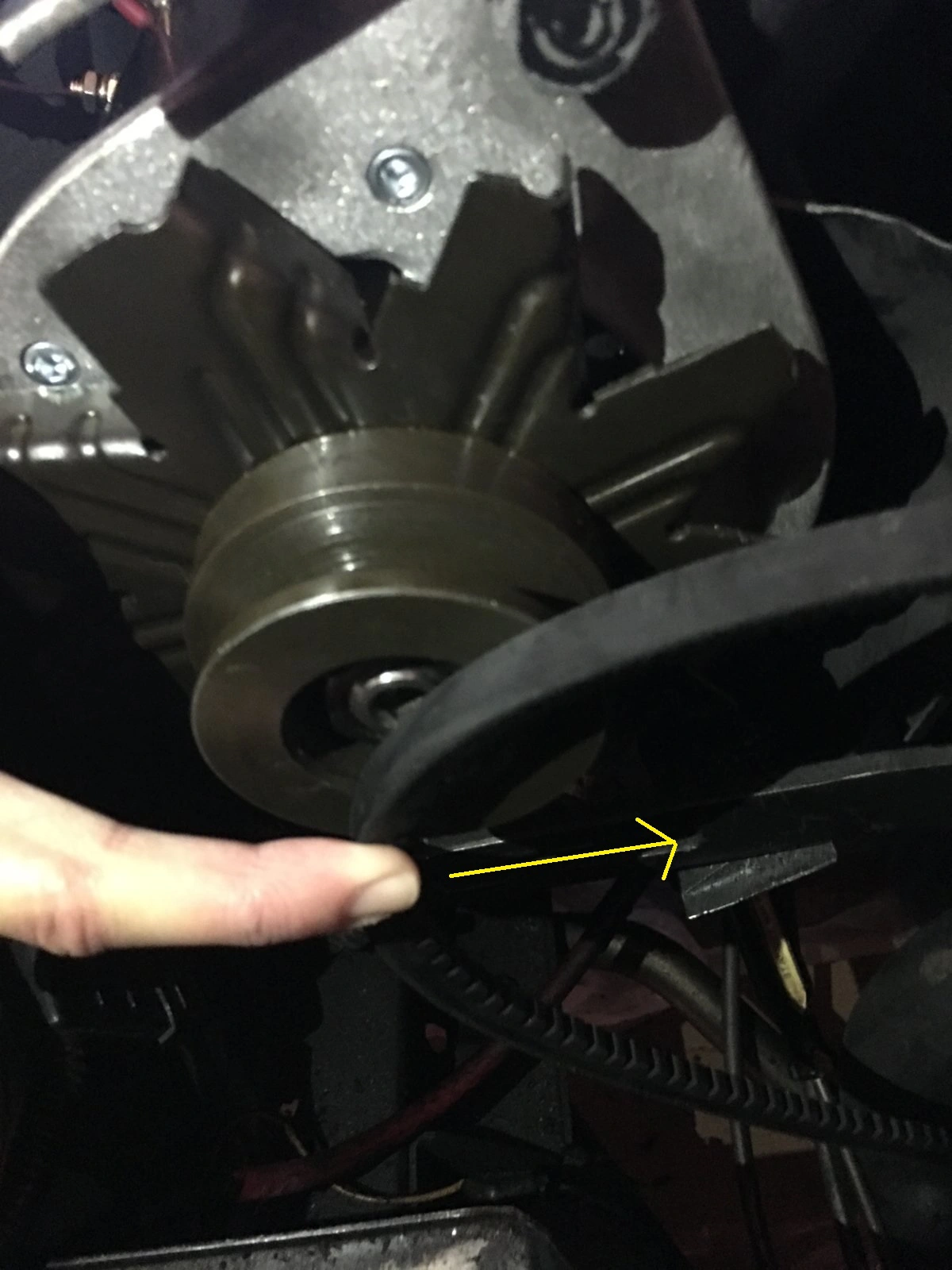

Hello, all. I have been working on converting the original generator in my 64.5 Mustang (260 engine) to a one wire alternator. (Don't worry purists, I am going to rebuild the orignal generator and keep for posterity:).
I have everything lined up, but can't get the belt around the alternator pulley. I have created as much room as I can with the new alternator (Pictured) but can't see where to get any more room to get the built over the alternator and then tighten everything back up. I have intentionally left the bolts at the top loose so I have as much room as possible to get the belt over the pulley. I have never done this exchange before and I am sure I am missing something, but can't figure out what it is! Can someone give me a few tips that I can try? The old generator and the new alternator are the same size, so that isn't the problem. Any advice appreciated!
Thanks,
64vert

That slot in the lower bracket is for adjustment, push the bottom of the alternator towards the engine, and see if the belt won't make it over the pulley at that point, if not, you'll need a longer belt, trying going up a half an inch in size (and if the parts monkey at the auto parts store doesn't know how, let me know what size and brand and I'll convert it to the next part number for you).
