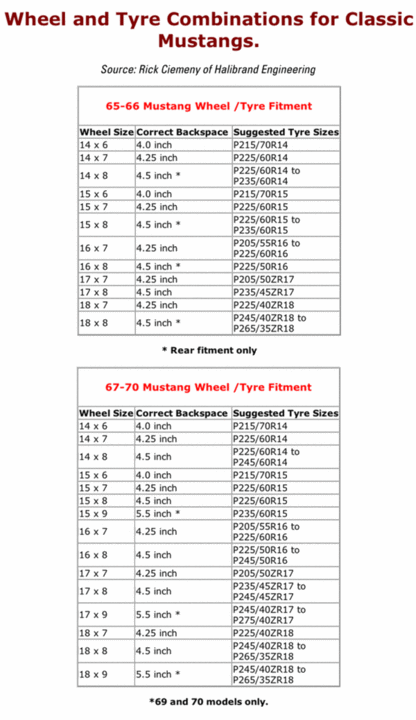

getting a 245/45/17 to fit on the front
Even with perfect backspacing, not gonna happen. This is the tire chart for maximum unmodified tire size. The tires you suggest will require rolling the lip, and probably even flaring the fenders.
right now the wheels are stock mach 1 17x8 wheels with 5 3/4 backspacing. I got a set of 1.5" wheel spacers that I was going to mill down to 1" right now and see how they fit. I'm thinking i could get by with 4 3/4" backspacing on the front if i maybe roll the fender lip
I don't think I would trust that list entirely 100% of what WOULDN'T fit for sure. It has quite a few sizes not on there we've put on personally. Like 18x9 on a 275 on the rear of a 65 or 315's on the rear of a 67-70

well i had some 1.5" spacers lying around. I threw on one side to see how much i'd like to remove. I'm going to machine the spacers down 1/2" all the way around to give me a total of 4 3/4" backspacing on a 17x8 wheel with 245/45/17 tires. I'll roll the front if I can, if not get smaller tires...i'm limited by getting the wheel in the wheel well more because it looks like if I go more than 4 3/4" backspacing the wheel is going to hit the upper control arms
