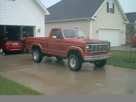

1985 Ford F-150 by Critic_Man, on Flickr
Bought a 1985 F-150 RWD Auto last night. It is indeed carbureted. Thanks for the forum link as well as the differences between the motors. Condition is as you would expect for an '85. I have a nice list going from my recollection on my Stang as far as refresher maintenance to make her a little more solid. Also needing to learn more about carb'd vehicles. I'm guessing I'll find a wealth of info on the Ford Truck forum.

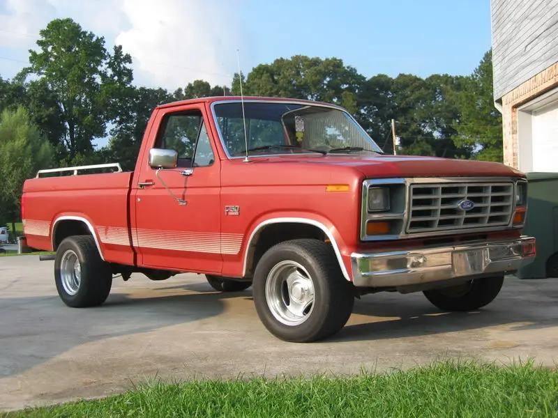

Since everyone else is posting there's, Here's my old '86...It was the one of the best running vehicles Ive ever had
