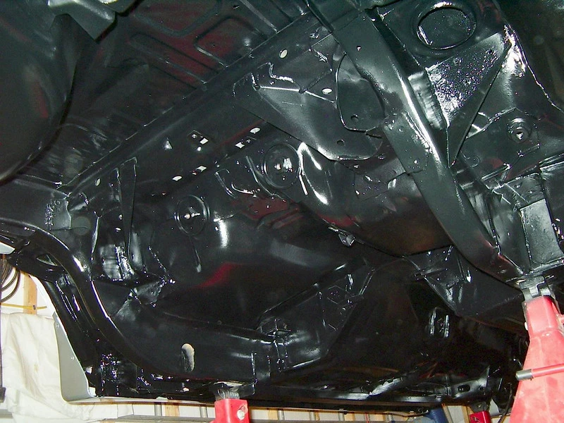

Only a quart? Hahaha. That may be just enough to put one coat on your wheel wells. I put two coats on the entire underside, interior floor pans, wheel wells and engine bay and used up two gallons!! The stuff aint cheap and one coat isn't going to be enough, so be ready to buy more than a quart. It's also best to top coat POR-15 with some primer and paint... it's tough but turns "chaulky" looking if exposed to the elements. Here's how minw turned out.
2 coats of POR-15 and 2 coats of primer:

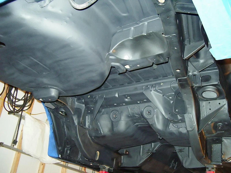

Top coat of gloss black:

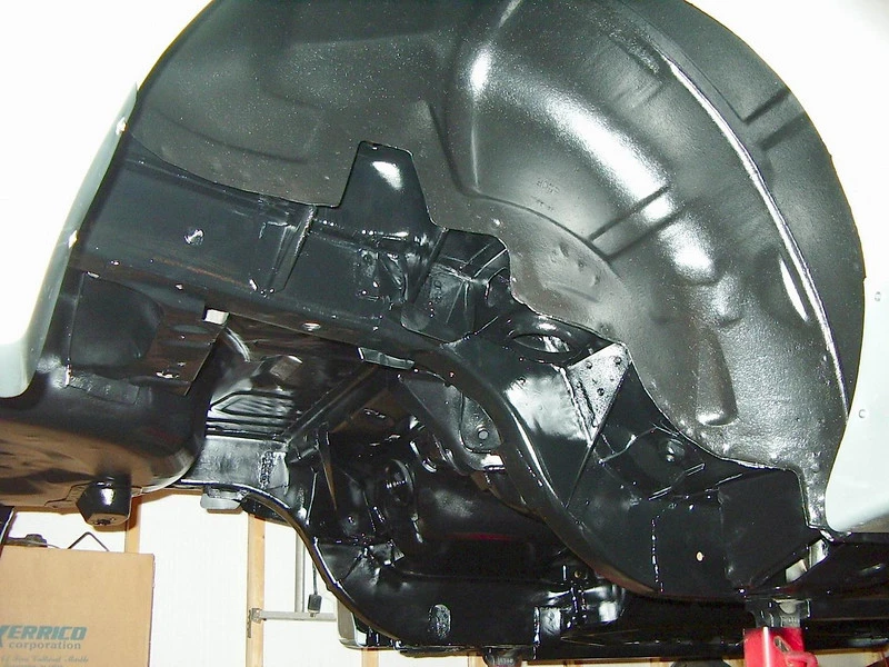

Wheel wells got 2 coats POR-15, 2 coats primer, then 3 coats of Herculiner truck bed liner:
