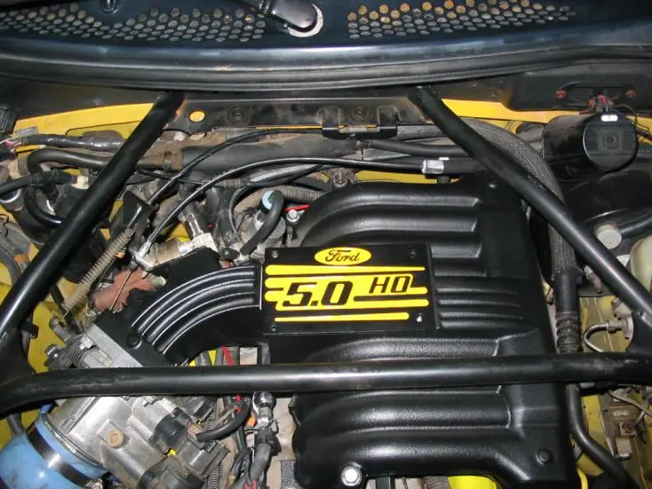

Do you still have the GT40s? Or was that part of the plan that you never got to buying cause you found the sweet deal on the eddys? Also, yeah, there's almost no difference in performance from the gt40 to the cobra intake, and getting the lower ported is the one thing to do. :nice:
Yeah, I still have the GT-40's. They came off a running explorer motor, just can't remember how many miles. Planned on doing the ebay thing with them but if you're interested, send me a PM. I also have a used set of Trickflow springs and an extra set of valves to go with them.
I might stick with the Cobra intake. Was just thinking I'll need the elbow too which will add to it's cost. Hmmmm, still up in the air about it.
Yeah, and once you put the elbow on, it doesn't look quite as sexy as it does on a fox body, haha. Just paint match the intake to your engine and it looks pretty good.
