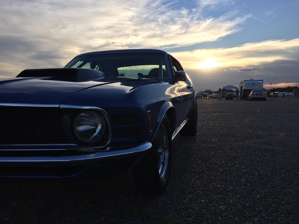

Hi there. Have a 70 drag car and for the life of me I can't get the rear of the hood to close tight enough. I have tried everything as far as hood hinge adjustment but no success. The rear of the hood is always higher then body line. Any suggestions.
