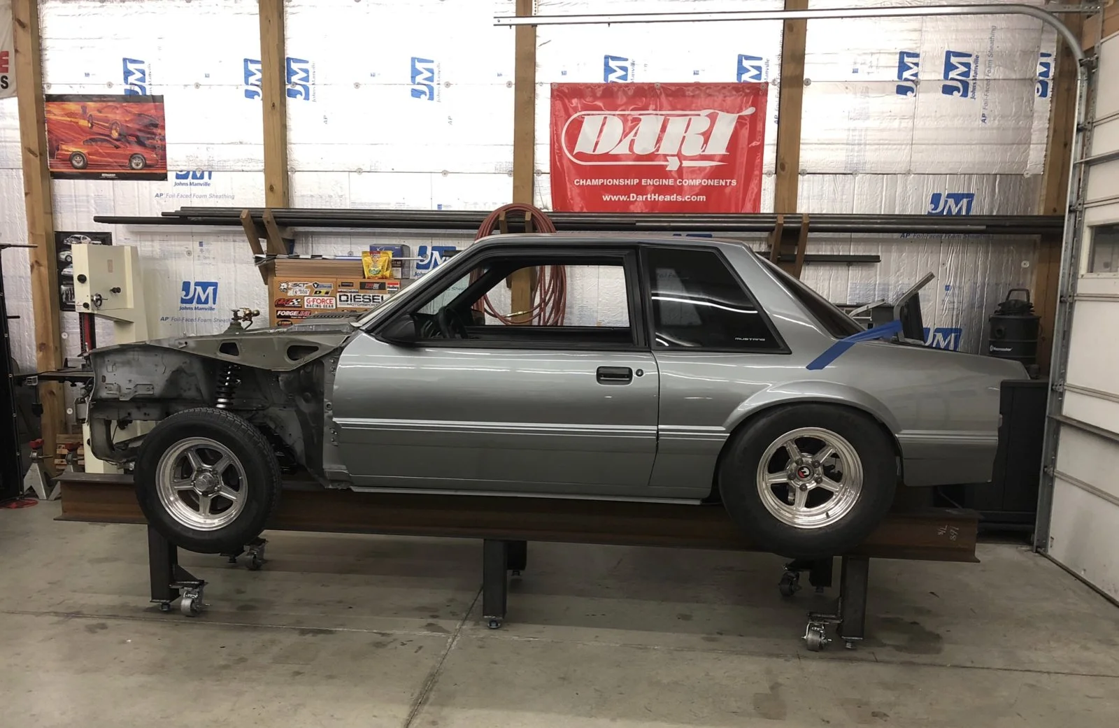

So dropped the car off for some mini tubs and other suspension work yesterday...how much are you guys paying labor wise to have this done? All the custom/metal shops by me are time and material so trying to get an idea of what ill be looking at. Also planning to keep the factory fuel tank/straps as my car is street and show only and it makes it alot easier to upgrade to the fuel system i want this way and it looks more factory which is ultimately my goal.
Want to run a 325-345 rear tire...

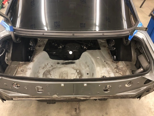

I can't help much with pricing as my mini tub install was rolled in with a ton of other work, but I can say it is easier (and cheaper) to do a cage at the same time as opposed to later, if it is your goal. It really isn't that hard to keep the stock style tank and straps with the mini tubs, you just cut out the front of the spare tire well for the shock cross member for the shock mount, instead of cutting out the whole thing. This is what I'm having done to keep my BBRC tank. Mine will have a TRZ ARB and shock mount with Viking coil-overs.

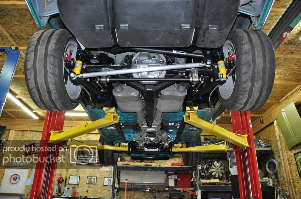

although mines an sn Its minitubed, narrowed and has a 345/25.20. you wont have a problem fitting it . tails will be a pita.
your ph bar might work as I also run a griggs watts link out back although I have a cell no tank its tight but fits. 69clarks pace car is mini tubed and also has a 345 out back. As for price cant help ya did the work myself.

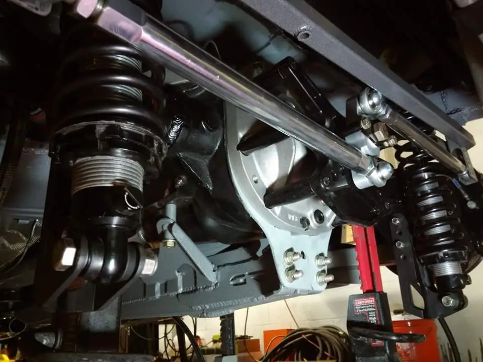

Not my car, but why won't the MM PHB work with coilovers?
If your concern is with the inward mount coilovers i can tell ya its gonna be really tight and you may need to make some adjustments with your shock mount. My advice is measure measure and measire again.
