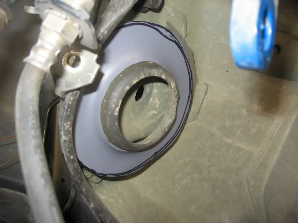

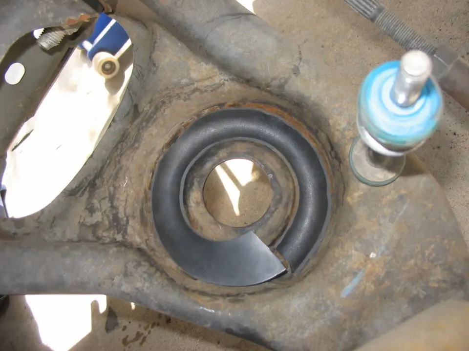

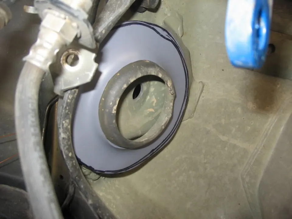

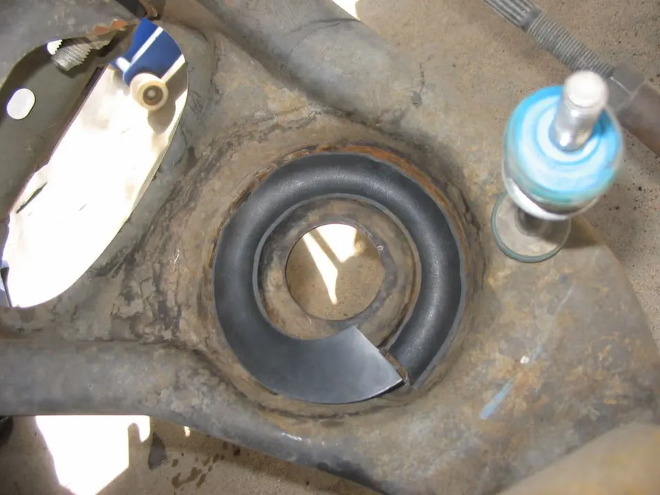

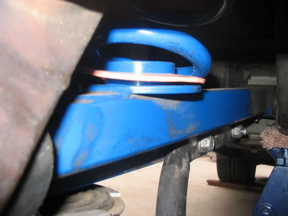

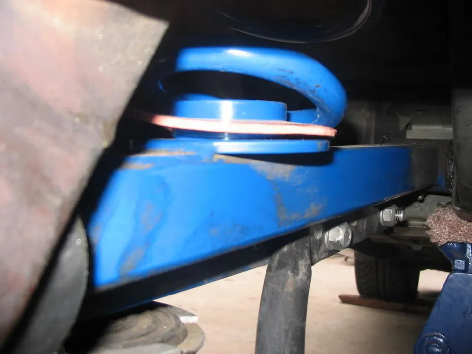

I have removed all of my isolators and made new ones out of 1/8 inch rubber sheets...you can see it here...and this is the stance it gave me with H&R supersports. (it has settled slightly since this picture). Anyways...enjoy...
Upper Fronts:
Lower Fronts:
Lower Rears:
