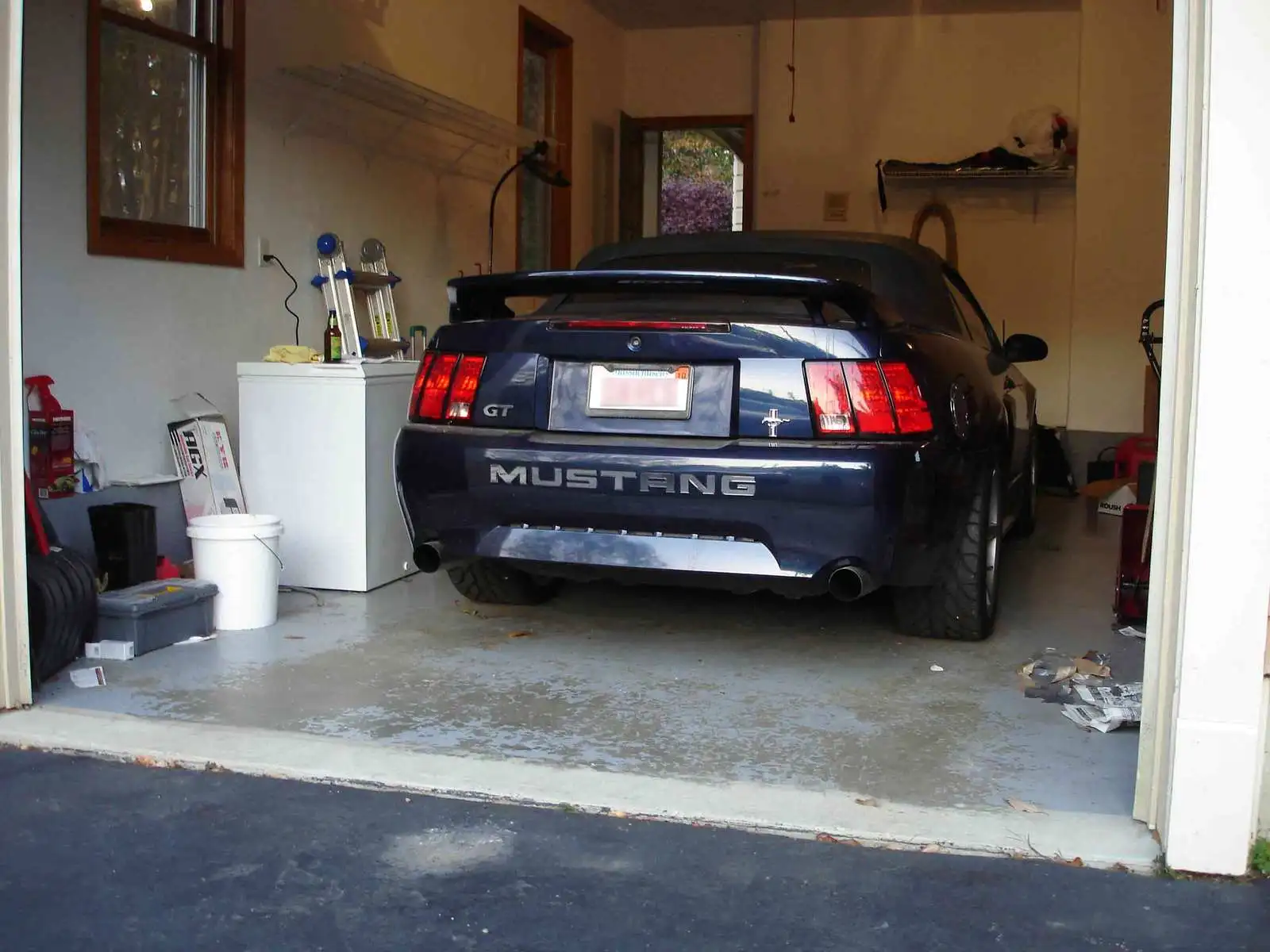

Found an old pic....
While I'm at it I may as well whore out a pic of the Roush Stage 3 wing that I just got done installing... My car is filthy I know, but I love the new spoiler!:nice:
I'll do the Stage 3 nose this winter while shes in the heated garage.:nice:

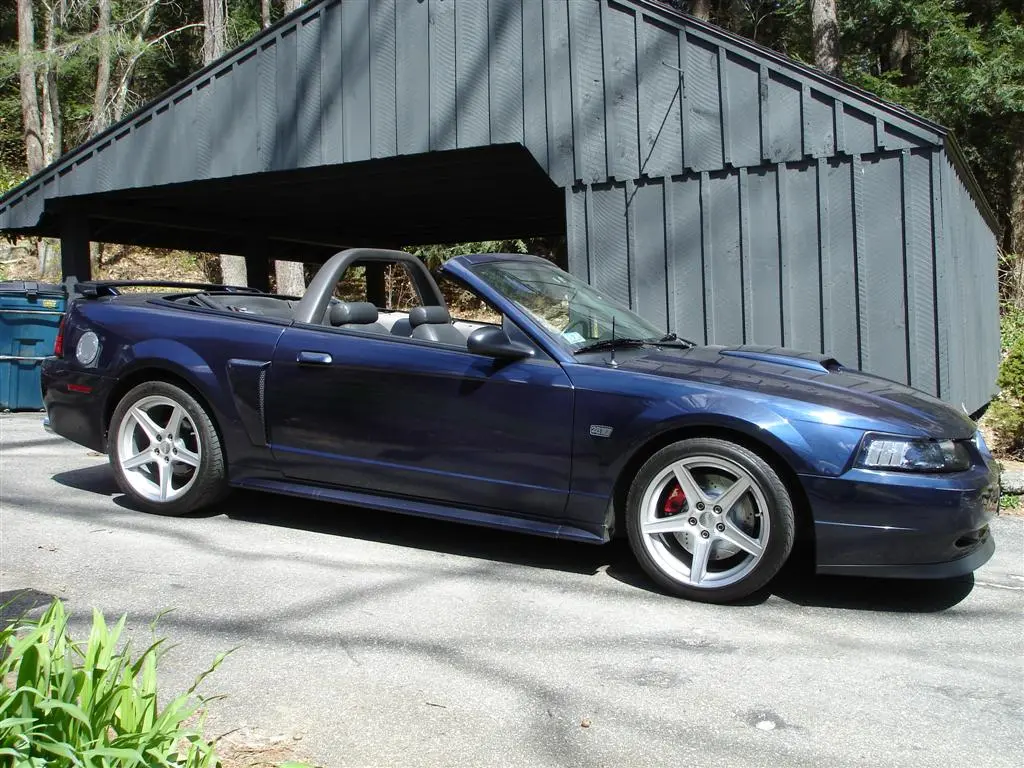

That's how mine used to look... see sig picture. Now the tire almost doesn't clear the wheel well opening from the side. :(

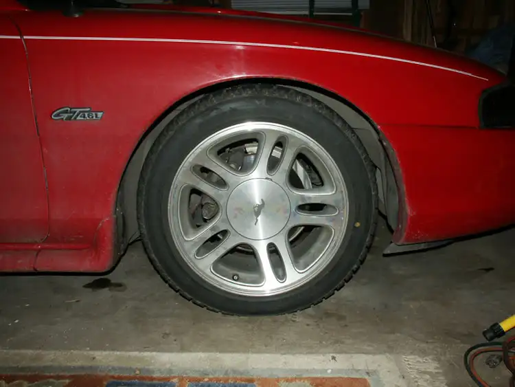

See how low it is...? Excuse the dirt, it's snowing here and the car is pretty dirty. Those are Blizzaks on it right now but they are 245/45R17, same size as original tires.
