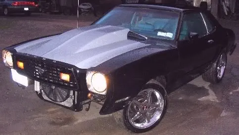

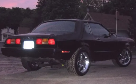

If you do find a coupe they can be made to look great too! All you would need was the Cobra II chin spoiler and scoop or your choice. Here is my 74 coupe, and yes it has a v8 swapped in.

jydCOBRAII said:
Bluethunder, that is cool hood. Probably allready been asked, is it one piece or did you mold it on.?
Thanks, I looked around for a long time for that particular scoop. A guy on ebay was selling those scoops, and I glassed it onto the stock steel hood. If you check out the link for my cardomain page, there's pics of the bonding process.
