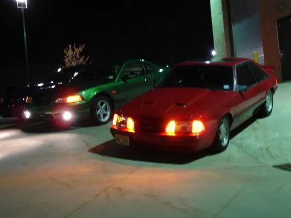

11.4@122?!?! i would be as happy as a 5 yr old at a candy store lol. the intake on the car now is an edelbrock performer 289, i have the air gap layin around an i figured it would be better. as for the hood, well i have attached a pic of it its a 2.5 inch cervini's so i think clearence whise i should have no problems. the spray plate is an inch an still the motor isnt close to the hood. also have welded in subframes, only thing i think will stop me hittin 11s is the springs, there sportlines an allow no transfer at all. i sprayed 50 shot on the street once an even with the nitto drag radials hot it still spun all through 2nd an 3rd. pulled really good! if i hit anywhere near your trap i would be seriously happy enough to hump my car
car is 3200lbs without my sub/amps in the back. with me an about a half tank.
heres the hood i have. my car's obviously the red hatch lol
