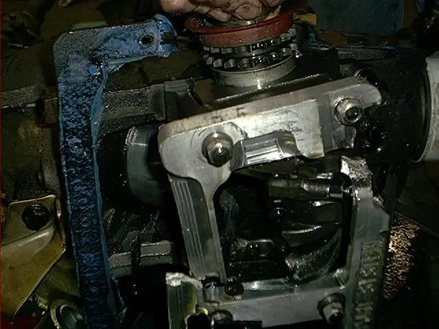

arhhhmm
on a dyno 570hp and like 580 or so torque @ 3,200 rpm
w/ like 13 lbs boost. both girdles didn't do anything but hold the pieces in..

I still like the main girdles, in most cases if the block breaks they will save the rotating assembly and I think they do help a little. I also like the DSS girdle (ALUM) the best they fit great. I think the alum grabs some of the harmonics and could possibly help the bearings.
NOW nothing will take the catastrophic event of a crank breaking like the above picture, I've seen 4 bolt blocks break because of that. You must have the mains checked and possibly align honed with the girdle installed, if not this could lead to other issues.
