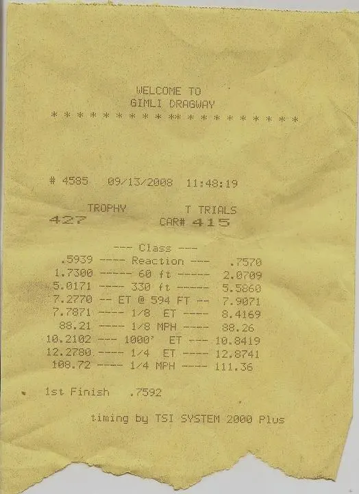

I'm car 415:

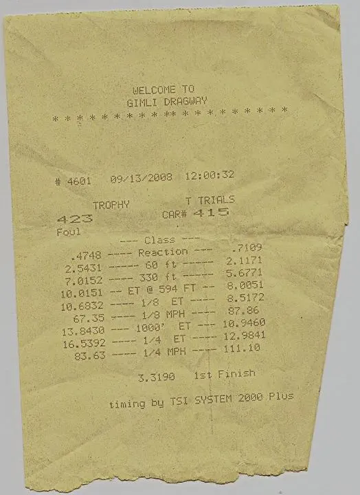

car 415 second best time:
With thoes speeds, if you got her to hook it seems 12.2s are possiable. If all the stars alighned just right you might even pull a high 11 :nice:

Very nice my friend! :nice: Sounds like all you need is some traction. What you want to concentrate on is your 60ft times. Reaction times mean jack squat in a race so don't worry about them.
With a nice set of Drag Radials a 1.8 60ft time is a realistic goal. If attained you will net a 12.4-12.3 ET. And the #1 thing of all is that it sounds like you had a blast!:nice:
