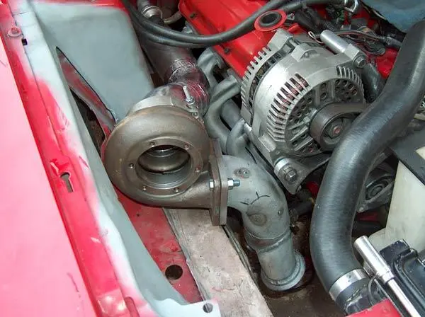

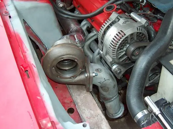

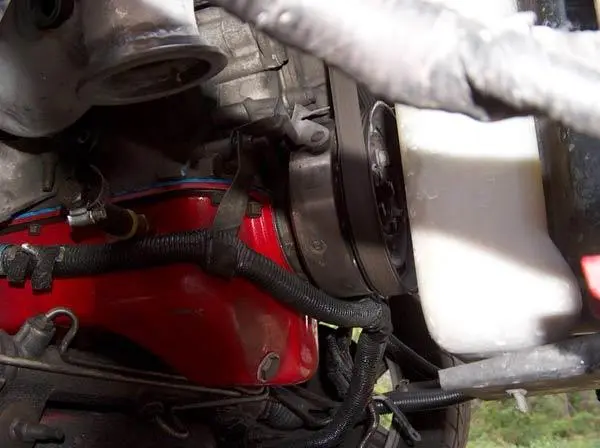

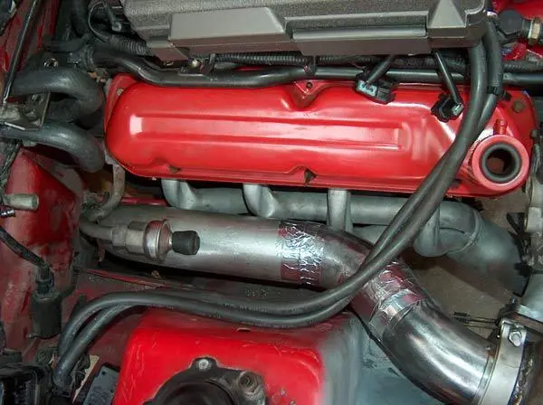

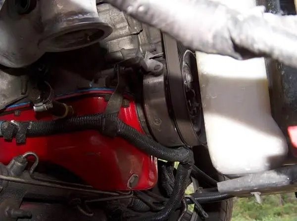

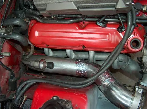

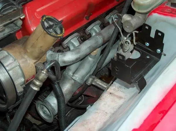

just got some pics of the hot side mock up from oink and 1105.
driver's side:
passenger's side from the front:
underneath; crossover connection:
