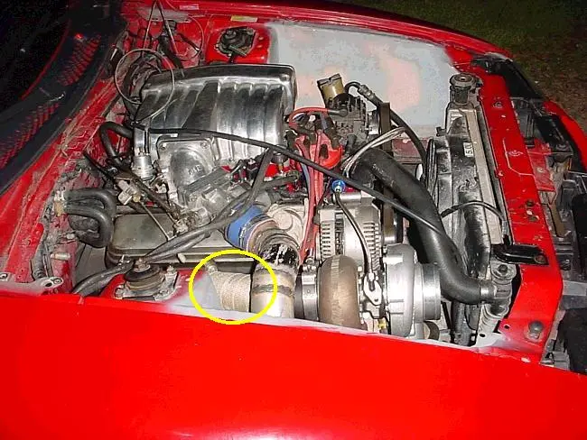

I have a couple of questions:
- will a 1st gen DSM BOV do the job for my setup? I'm thinking it will.
- what, if anything, should i wrap with this heat wrap stuff i circled below in yellow? sorry, i don't remember the correct name for it. just the downpipe? the crossover?

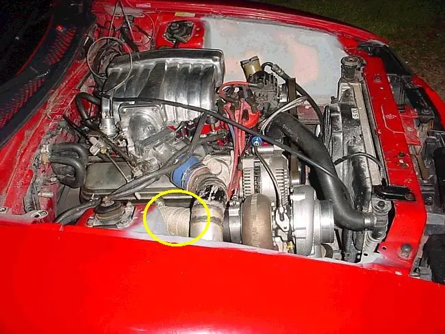

But I have a couple of questions while I am waiting on the hot side:

Yes, 1st gen DSM BOV should work fine for you. I believe they can support around 15lbs of boost uncrushed.
I would wrap your downpipe in your engine comp. I havent yet wrapped mine...and the underhood temps get extreme!!! If at all possible, get a heat shield or turbo blanket. You may have a bit less heat than me, as I have an extra turbo and downpipe...which means less room between all components.

will 50' of header wrap be enough for the crossover and the downpipe?

For the header wrap I just bought a little box of it from a local speed shop. Dont know how long it is, probably 50' so that should be fine. I still have some left over too.
I used a 50ft of 2 inch black Thermotec to do my crossover and downpipe, and had a good bit left over.
