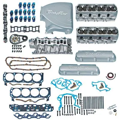

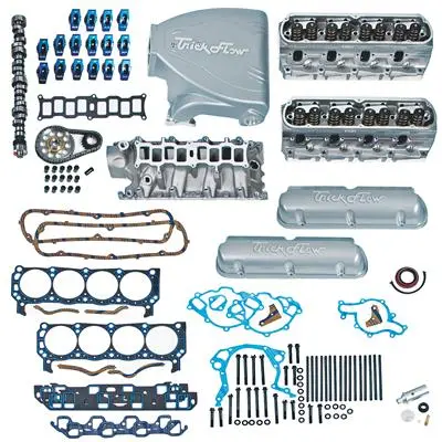

GRGT1994
Sep 22, 2004
1,034
Jan 18, 2006
#19
  • Jan 18, 2006
  • #19
SUPRCHRGD302 said:
Yes....the kit comes with new 1.6 rockers.
Look in the bottom right.
Maybe you were thinking of the lifters? (Oh hey look, there's the timing chain - guess that did come with the kit)
BTW, I thought of one other thing you need to get that is NOT in the kit. You will need an oil fill neck. The TFS valve covers do not have a fill neck, and for some stupid reason, TFS don't include one in the kit. So order one of those.

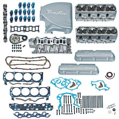

SUPRCHRGD302
May 11, 2005
20
Calgary, AB
Jan 18, 2006
#20
  • Jan 18, 2006
  • #20
Call TFS or Summit Racing tech line and ask them the same question about what else you might need or want. I talked to both of those lines a number of times when I was building. And except for one unhelpful troll I talked with once (and only once - I don't think he was really supposed to be answering the phone) they were incredibly helpful.
Good call!
Correct, i forgot to mention that....lol. Why they wouldn't include that in the kit is beyond me.
