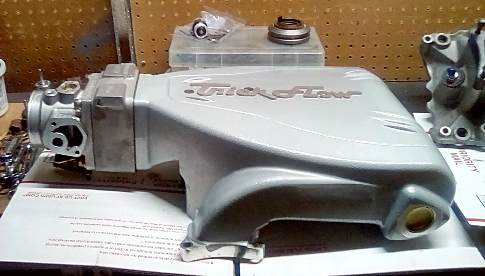

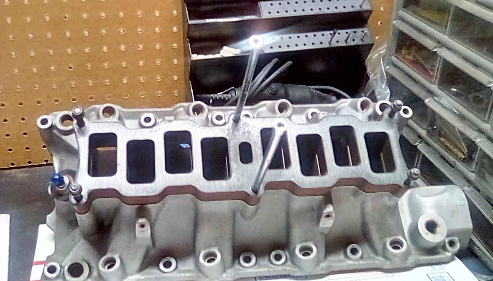

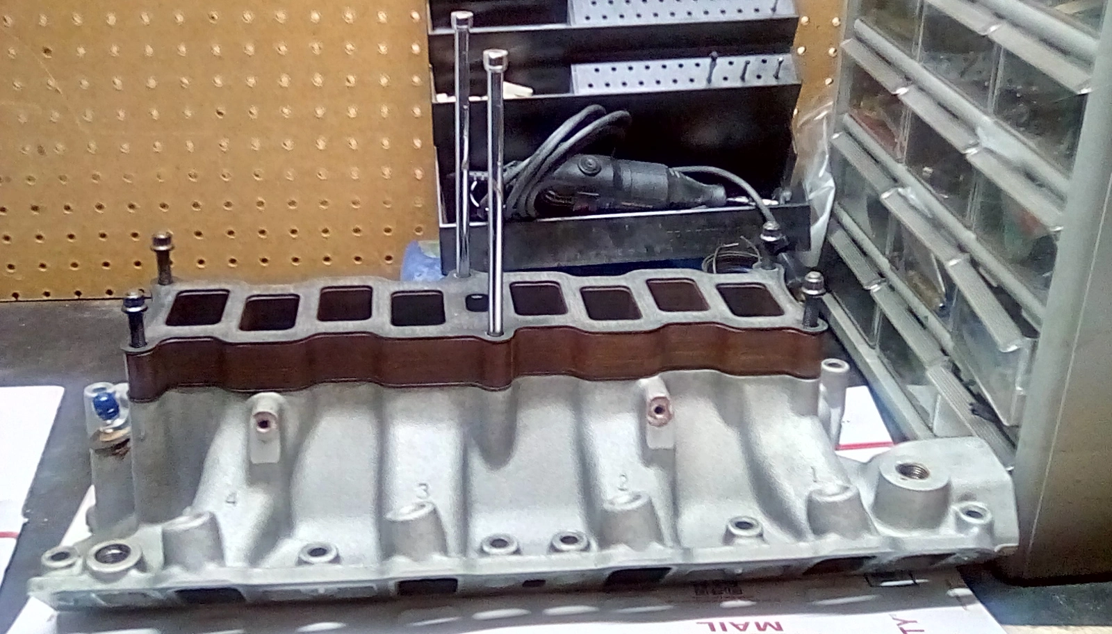

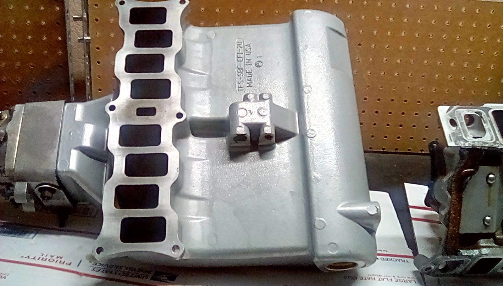

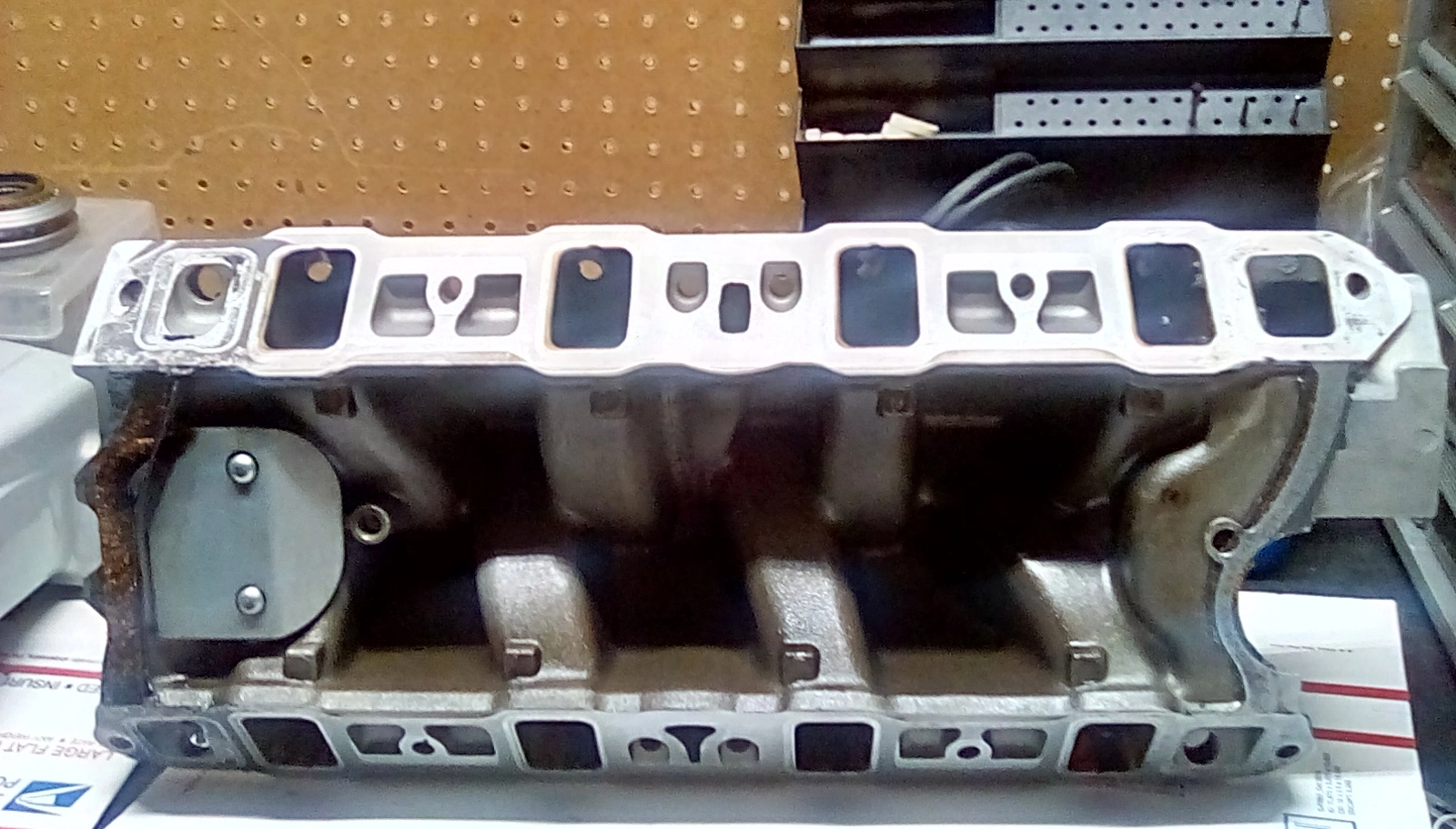

I was cleaning up the intake and guy I got it from did some turbo mods to it.
The pcv was glued to the grommet,grommet glued to intake.( He said the pcv would launch like a rocket under boost)
The egr spacer has coolant tubes removed and taped for plugs( see pic)
Also on pass side near #1 runner where water pipe screws in,he put a smaller fitting and had it plugged.
I got a little work to due.

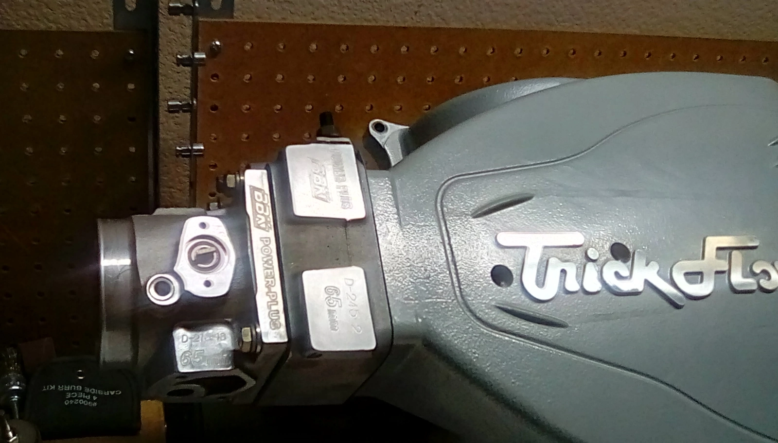

The only issue I've heard of with BBK throttle bodies is their tendency to whistle at or near idle.
I've read you can remedy this by drilling a small hole in the butterfly plate.
I have a 75mm BBK and yes occasionally it will whistle just off idle but never enough to bother me
some day I may drill it.
