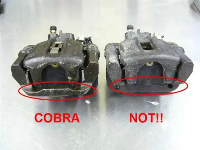

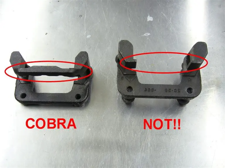

Out back...
all 94-04 use the same calipers, but the cobra/mach1/bullitt use a different pad support bracket to clear the wider rotor. You will need to find these, and I believe rockauto.com and parts stores do sell them separately.
These pics show the part I'm talking about
But as far as the actual rear caliper that pushes the pads...same part on all 94-04. Pads are thinner on the cobra though.
Other than that, for your V6, if you bought the M-2300-M kit for out back. the only part you need to get would be the bracket I showed above. You could then resell all your v6 stuff (same as GT) on CL or ebay and recoop some funds.

I've installed that kit. It doesn't come with the caliper bracket. You still need to get it, or you can grind out your GT calipers with a die grinder to clear the rotors.
Used to be a company that sold the rear caliper brackets separate. Trying to find them for you.

Here's the rear caliper bracket
http://www.americanmuscle.com/reman-rear-caliper-bracket-9404.html
If cost is a concern, just focus on the fronts. Unless you are going to go road racing or want to fill up your rims in the back, the rear brakes aren't as critical to do.
