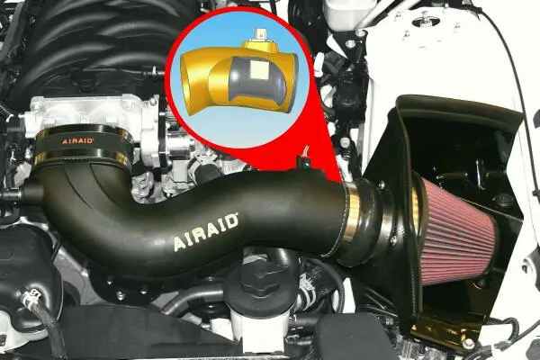

Heres a picture of what the "Modular Venturi Tube" looks like.......I did not know anything about a Venturi tube till I read this post and I researched a little because I assumed with the Airaid CAI the car would have been re-tuned and I learned if it has the Venturi Tube in it, it doesn't need a retune.
So heres the pic, I assume the Venturi Tube is whats highlighted, looks like you may have to pull the filter off and have a look inside (how you're gonna tell if it's the Venturi Tube is beyond me) :shrug: If I were to guess the Venturi Tube is basically the MAF housing, and being it does not need a re-tune, the housing is basically the same size as stock, which really means no gains. This is just my guess.
EDIT:Ok I did a bit more research on this Venturi Tube, its either there or its not, if you pull the filter and look inside the housing and see that tube thats highlighted in the pic, its there, if you see nothing but a large opening its been removed and re-tuned.
MODULAR VENTURI TECHNOLOGY
This is the Venturi Tube.
Best of luck :nice:
Thank you for the info. Yes it has the venturi tube installed. We have been putting 88 octane in it and it runs great.
